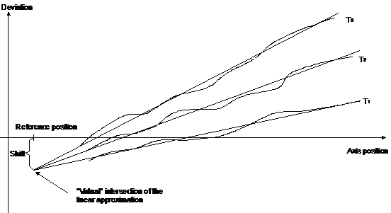

Reference measurement
Before specifying the parameters of temperature compensation, a reference measurement must first be carried out using an external position measuring system. It determines the deviations of the axis positions between the internal and external measuring system at different temperatures.
Parameterisation 1:
Reference measurement at different temperatures
Determine parameters
The parameters reference position, offset and coefficient can be taken from the measurement curves. The values at a given temperature can be set later from the curves. Temperatures that are not measured can be interpolated or extrapolated from the measured temperature curves.
If the virtual intersection of the approximated linear curves is chosen as the reference position, the offset is independent of temperature. In this case, only the coefficient must be reset for different temperatures.

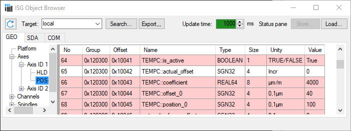

In addition to the download option, there is also the option of writing and reading the parameters via direct access to the GEO task via CNC objects. For example, the first axis can be addressed via the following index group and index offset:
Parameterisation 2:
Access to CNC objects of temperature compensation

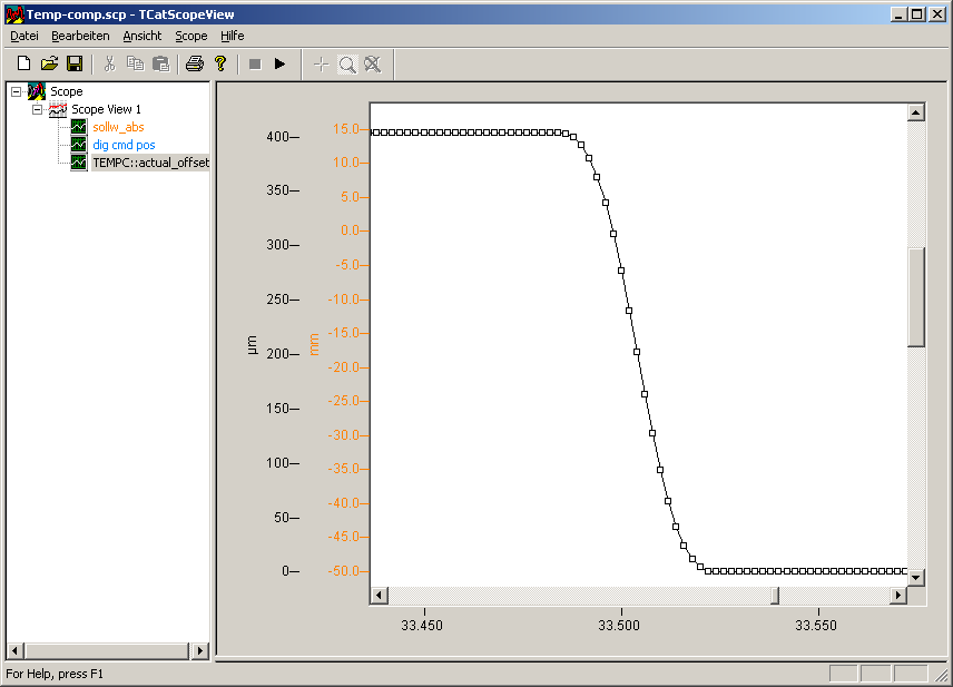

The compensation values are recalculated for each interpolation cycle. If the change per cycle exceeds the given maximum axis acceleration, this change can be output filtered over multiple cycles.
For this the number of cycles of the sin² filter can be defined in the axis parameter list. By default, this is set to one cycle.
kopf.achs_nr                          1
# Cycle of the sin² filter
lr_param.temp_comp_n_cycles          20
Parameterisation 3:
Deactivating compensation values with a sin² filter over 20 cycles by deactivating temperature compensation temporarily
Display the compensation
In addition to the download option, there is also the option of writing and reading the parameters via direct access to the CNC objects of the GEO task. For example, the 1st axis can be addressed using the following index group and index offset:
TEMPC::is_active                         Index group = 0x120300, Index offset = 0x10041
TEMPC::is_active                             Index group = 0x120300, Index offset = 0x10042
