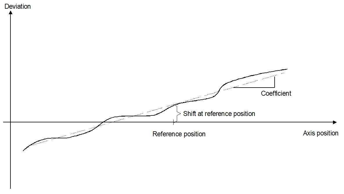

Overview 1:
Temperature-dependent falsification of the axis position
Compensation
Temperature compensation provides a function to correct the command variable of the axis depending on the current temperature and axis position.
The compensation values are determined according to the following equation:
Δs (T,s) = offset0(T) + coefficient(T) * [s-s0]
where:
s = current position of the axis
T = current reference temperature
S0 = reference position of the axis
Offset0(T) = temperature-dependent deviation from reference position
Coefficient = temperature-dependent ratio of deviation to distance from reference position

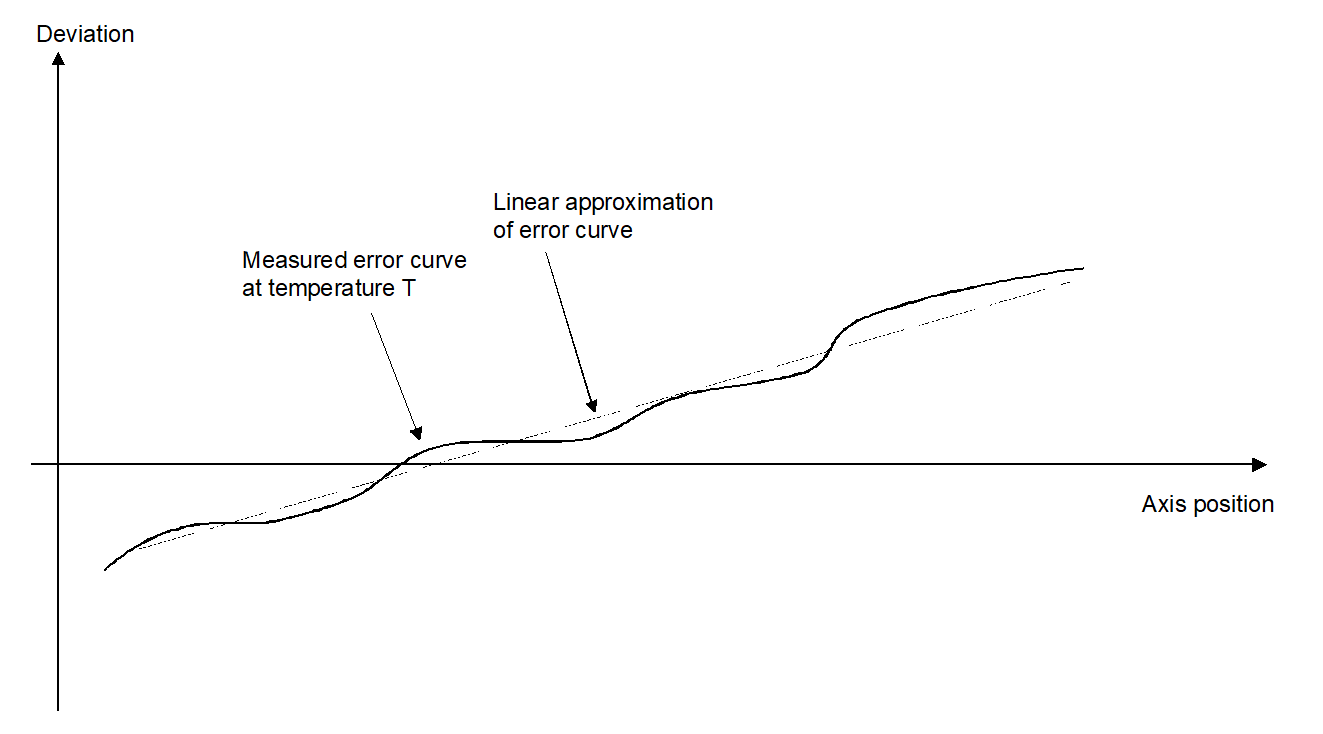

Overview 2:
Parameter of temperature compensation for a temperature T
