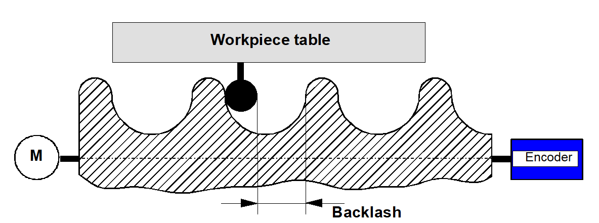

Positive backlash
Positive backlash occurs in systems in which
- the measuring system is connected directly to the drive and
- the backlash occurs between the drive and the moving mechanical part.
When the direction of movement reverses, the measuring system will detect a position change although the machine part is not yet moving due to the backlash.
This leads to a situation in which the machine part does not reach the commanded position, but travels too short by the backlash amount because the sensor that indirectly measures the position of the machine part is ahead of the machine part’s actual position.

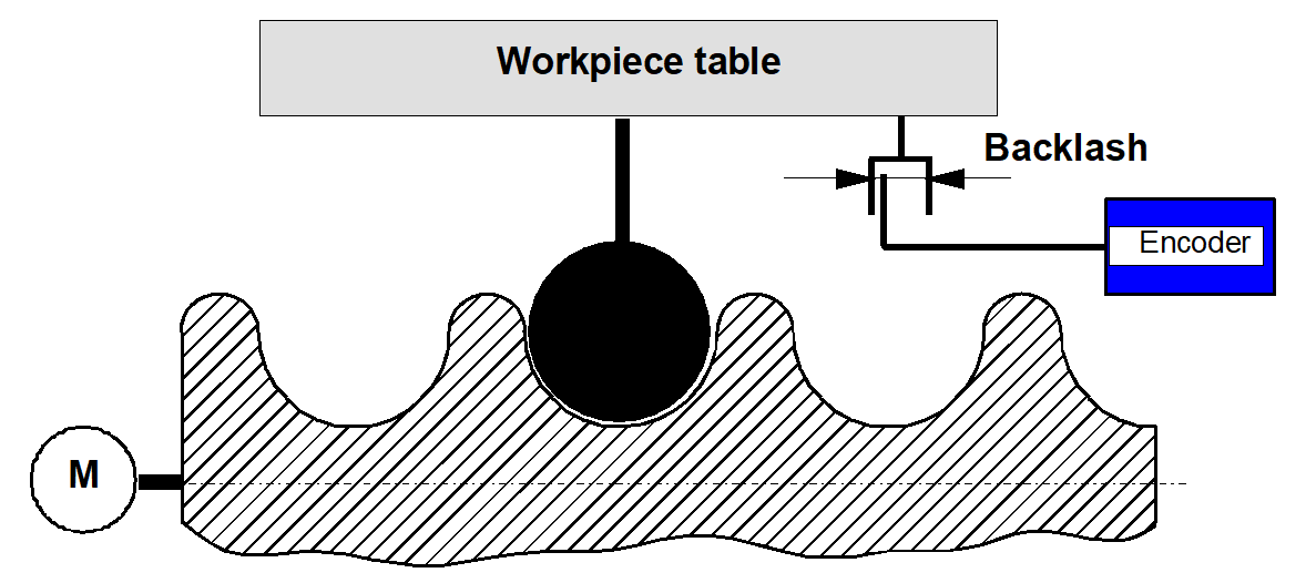

Negative backlash
Negative backlash is encountered in systems in which the backlash occurs between the moving machine part and the measuring system. When the direction is reversed, the machine part directly moves in the new direction without the measuring system detecting a position change.
In this case, the machine part moves further by the backlash amount than is required by the command because the sensor that directly measures the position of the machine part lags behind the position of the machine part.
