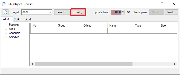

Static CNC objects available
The available static CNC objects are dependent on the CNC Build used.
A list of all available objects can be created using the ISG object browser.
Requirements:
ISG object browser is installed
Configuration is active in TwinCAT and TwinCAT is in RUNNING mode
Execute the following steps:
Introduction 2:
The generated list contains all the static objects available in the CNC version.
