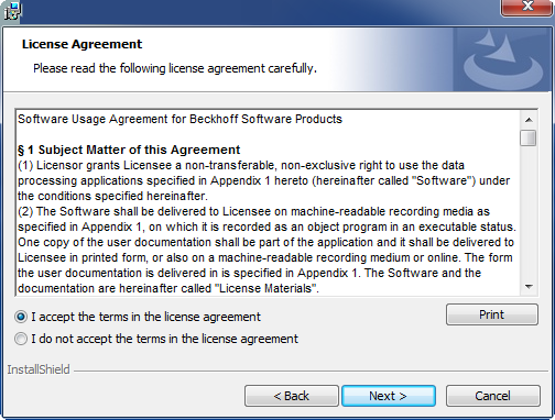

- 2. Accept the end user licensing agreement and click Next.

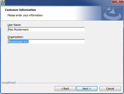

- 3. Enter your user data.

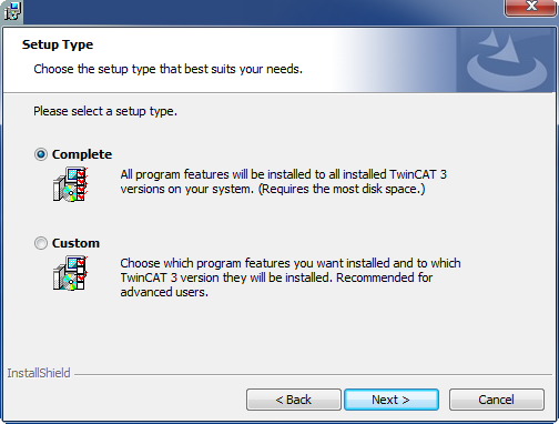

- 4. If you want to install the full version of the TwinCAT 3 Function, select Complete as installation type. If you want to install the TwinCAT 3 Function components separately, select Custom.

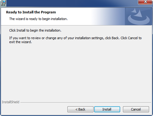

- 5. Select Next, then Install to start the installation.

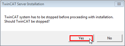

- A dialog box informs you that the TwinCAT system must be stopped to proceed with the installation.
- 6. Confirm the dialog with Yes.

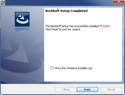

- 7. Select Finish to exit the setup.
- The TwinCAT 3 Function has been successfully installed.
