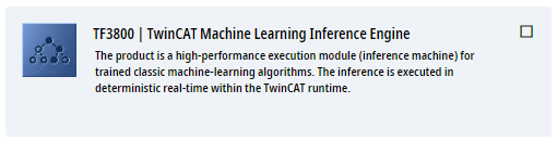

Install the following workload to be able to use the product:
Installation 1:

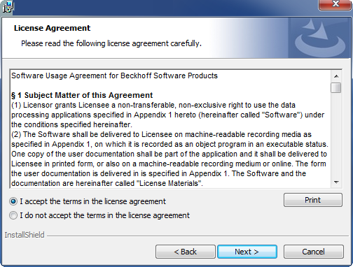

2. Accept the end user licensing agreement and click Next.
Installation 4:

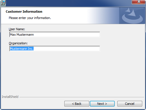

3. Enter your user data.
Installation 5:

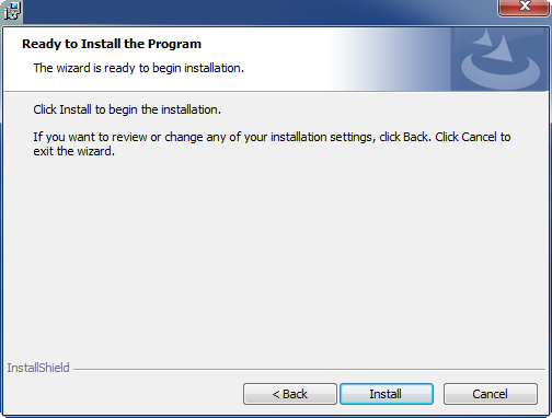

5. Click Next, then Install to start the installation.

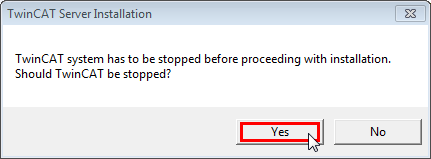

A dialog box informs you that the TwinCAT system must be stopped to proceed with the installation.
6. Confirm the dialog with Yes.

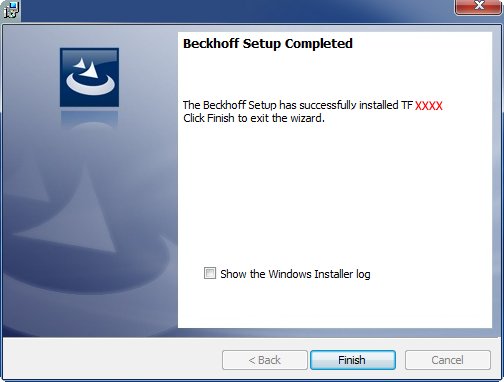

7. Click Finish to exit the setup.
Installation 9:
The TwinCAT 3 function has been installed successfully.
