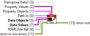

Notes on the "To TDMS" in the block diagram
The To TDMS block allows you to save ADS DAQ instance data to a LabVIEW™ TDMS file (the NI TDMS file format). This block is automatically generated by the ADS DAQ instance, but only if Queued has been selected as the notification mode, cf. Notification selection window.
The TDMS file format provides TDMS objects and TDMS channels to hierarchically arrange data or properties (name, date, ...) among TDMS objects. The inputs Property-/Data Objects can be used to reference or classify both properties and data. The inputs Property-/Data Values help to enter measured values under TDMS objects and channels.
Output  | Meaning  |
[0] Path In  | The path to the TDMS file  |
[1] Property Objects  | An array of a LabVIEW™ string:
 Sample: Property Object[0]=ObjectABC/ChannelXYZ:Name,Author,Date TDMS Object=ObjectABC TDMS Channel=ChannelXYZ Property[0]=name (string) Property[1]=author (string) Property[2]=date (timestamp)  |
[2] Property Values  | An array of LabVIEW™ variants:
[3] Transpose Data?  | Flag to transpose the entered 2D of 3D arrays.  |
[5] Data Objects  | An array of a LabVIEW™ string:
 The following format is used for referencing:
 Sample: Data Object[0]=ObjectABC/ChannelXYZ  |
[7] Data Values  | An array of LabVIEW™ variants with the following supported LabVIEW™ types:
The following graphic shows an example of the To TDMS block in use.
