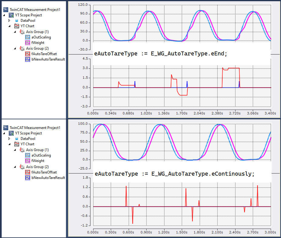

Automatic taring:
The instance fbScale
can be automatically tared via the fbWeighing
instance as follows:
// Execute AutoTare
IF NOT fbWeighing.AutoTare(fbScale, eAutoTareType)THEN
SetError(fbWeighing);
END_IF
Depending on the eAutoTareType initialization value, there is the following case distinction:
E_WG_AutoTareType.eEnd
(above): fbScale
is tared with the value fAutoTareOffset
if bNewAutoTareResult
is equal to TRUE
. E_WG_AutoTareType.eContinously
(below): fbScale
if fAutoTareOffset
is not equal to 0. After taring, a fbWeighing.Reset()
is automatically executed each time.
