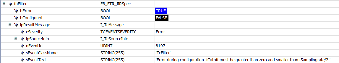

Return codes of the ipResultMessage.
Online Watch:

16#2005 | Error during configuration. fCutoff must be greater than zero and smaller than fSamplingrate/2. |
