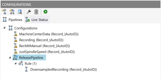

Recording definitions ("CONFIGURATIONS")
Local:
Historicize data 8:
Recording definitions that are saved locally are listed in the "Local" tab. New definitions can also be created here. To do this, press the "Create new definition" button. The following dialog opens.

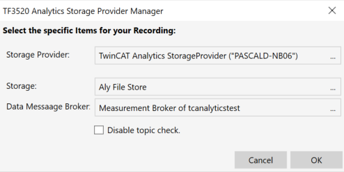

The following dialog then opens:
Historicize data 11:
Here you can now select the desired Analytics Storage Provider via which the definition is to be published. In addition, the definition is assigned a Storage and a Sub Broker of the selected Analytics Storage Provider. After the selection, the recording definition is confirmed with OK and published to the selected Analytics Storage Provider. This means that it can be found under the "Global" tab by any Storage Provider Manager that is connected to the MQTT broker.

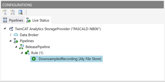

Started recording definitions are listed in the "Active" tab.
Active:
Historicize data 13:
All active recordings from all users are listed here. The recordings can be ended in this tab and it is also possible to jump to the resulting record.
