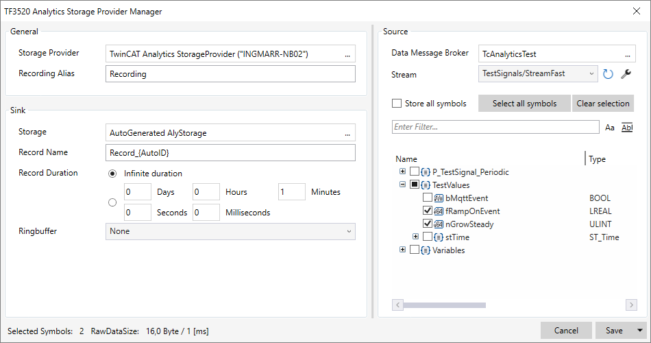

To create a new simple pipeline, click the Create new pipeline button. The following dialog opens.
Manager ("Recorder") 7:

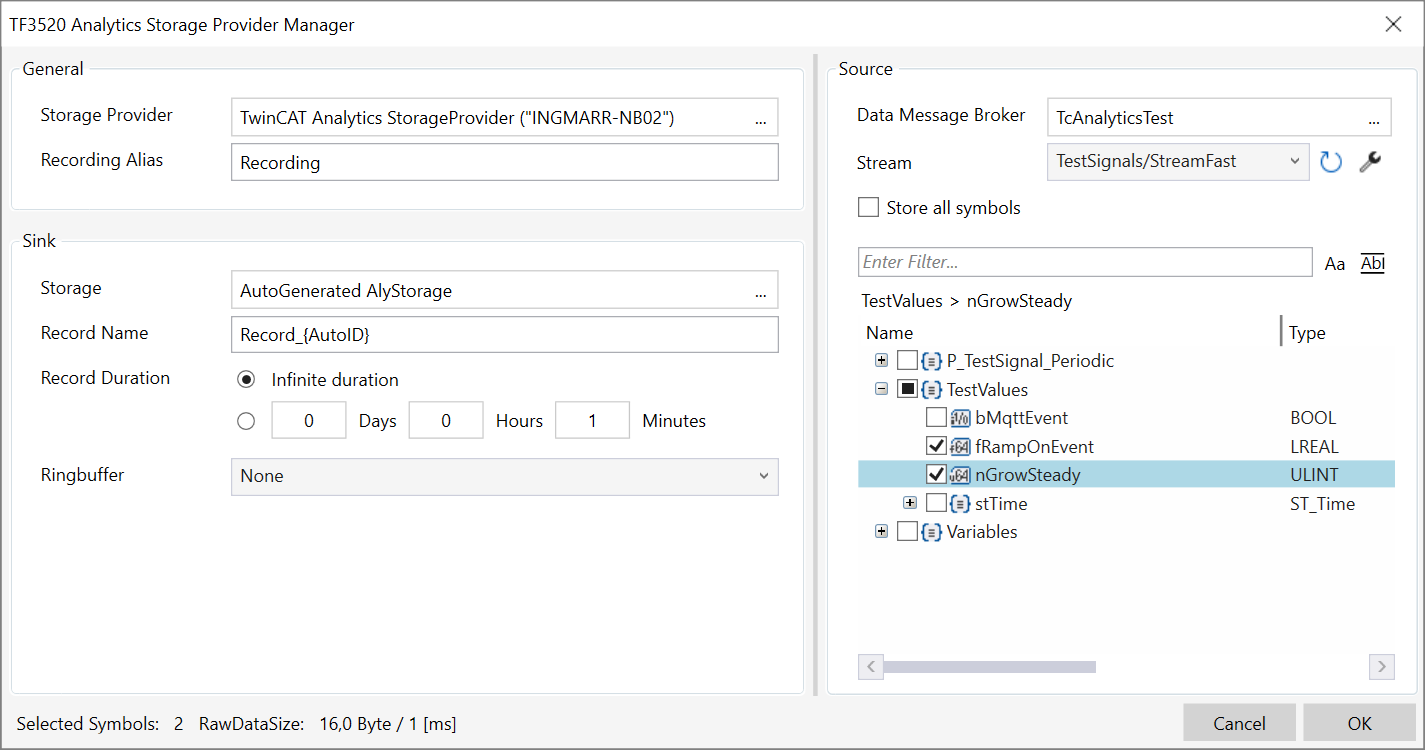

First, select the desired Storage Provider and assign a meaningful Recording Alias.
You can select the variables to be recorded in the right-hand area under Source. Use the Select all symbols button to specifically add all available symbols, including all sub-symbols, to the configuration. If a filter is active, only the filtered symbols are applied. If the symbols change while a recording is in progress and one of the selected symbols is no longer included, the recording stops and no further data is recorded. Alternatively, you can use the Store all symbols option. This ensures that all symbols available on the stream are always recorded automatically, regardless of the currently available symbol configuration. In this case, manual selection is not required. If symbols are added to or removed from the stream while a recording is in progress, a new recording is created and the data continues to be recorded.
In the Sink area, you have the option of defining settings for data storage. Here you can select the desired Storage and the Record Name. Various placeholders are available for the Record Name, which you can use as required:
"{AutoID}"
Automatically incrementing index
"{Topic}"
Topic of the stream to be recorded.
"{SystemID}"
System ID of the stream to be recorded.
"{Layout}"
Layout of the stream to be recorded.
"{CycleTime}"
Cycle time of the stream to be recorded.
"{SampleSize}"
Data size of a single sample in bytes.
"{RecordStart}"
Start time of the recording
You can use Record Duration to set the recording duration. Otherwise, the recording will continue indefinitely until it is stopped manually. In addition, you can define a ring buffer for recording in the Record Ring buffer area. The buffer size can be specified based on a time interval or a memory size. The latter mode is not available for all storage types.
The entries are confirmed with Save and a new local recording definition is created. If you have already saved the configuration, you can save a copy using the context menu of the Save button Save as Copy .

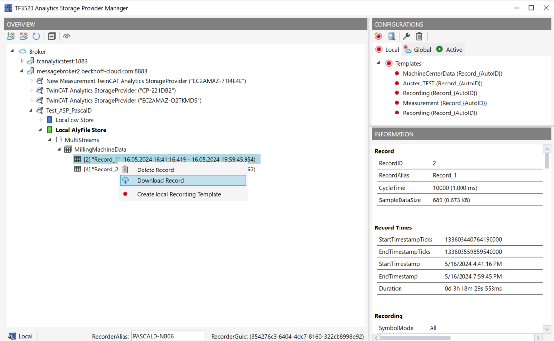

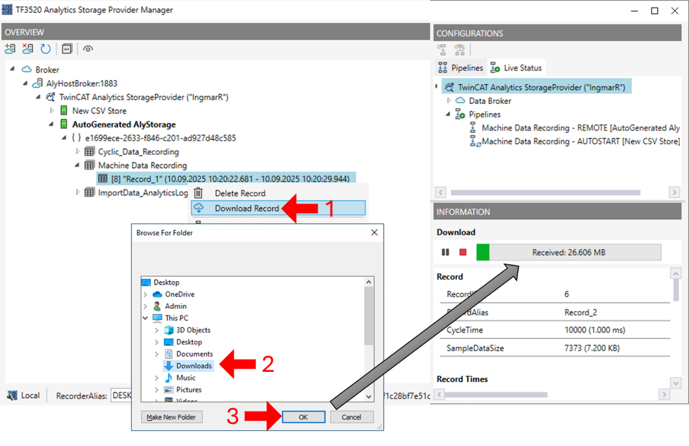

Furthermore, a download function is available in the Manager to download data to your local engineering. Select the corresponding record and start the download via the context menu. Regardless of the store in which the data is stored, it is always saved as an Analytics File on the local engineering system.
Manager ("Recorder") 11:
In combination with the data import function in the Storage Configurator, the Analytics File also serves as a practical exchange format. Both functions can be used to move data from a CSV file to an InfluxDB2, for example, or from a Microsoft SQL® to a CSV file, etc.

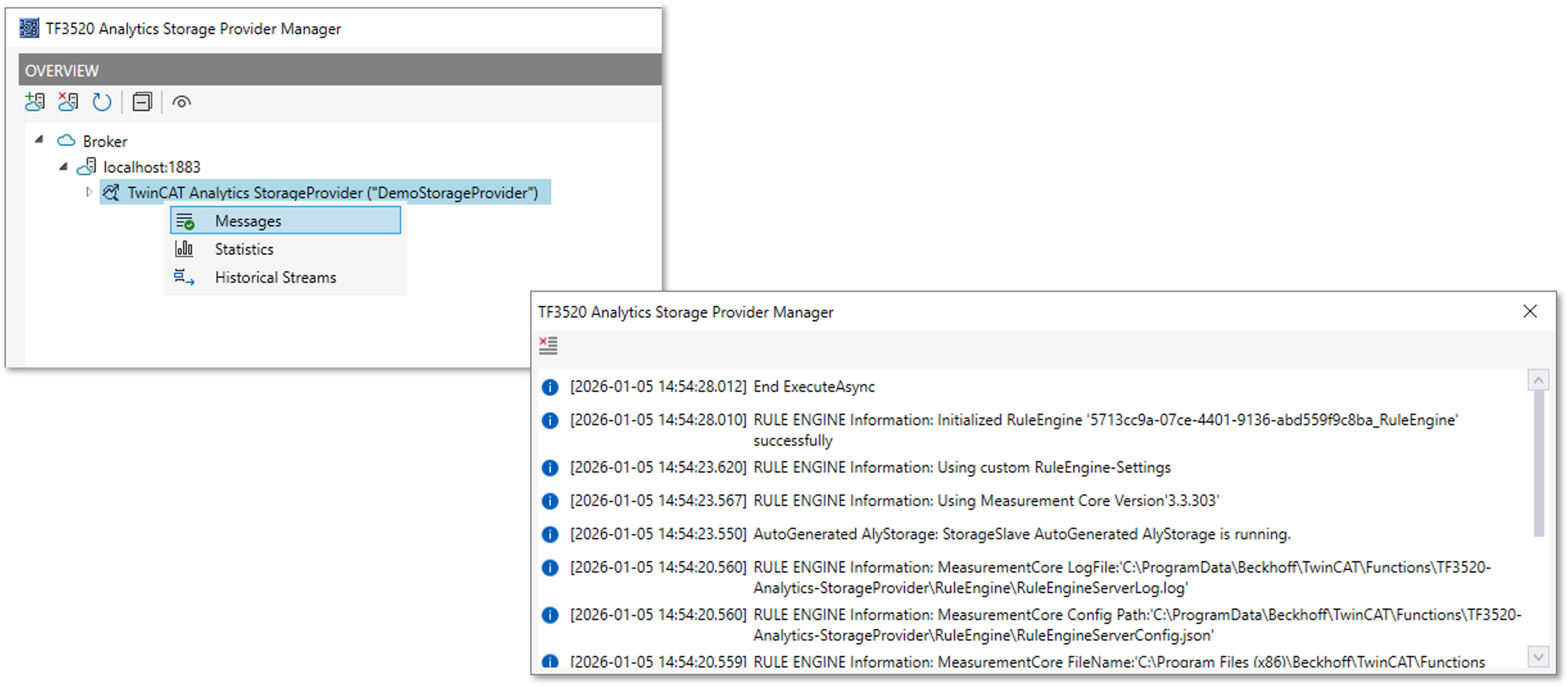

Viewing Storage Provider messages
The Storage Provider delivers messages via MQTT. To view these, right-click on the desired Storage Provider and select “Messages” to open the Messages window.

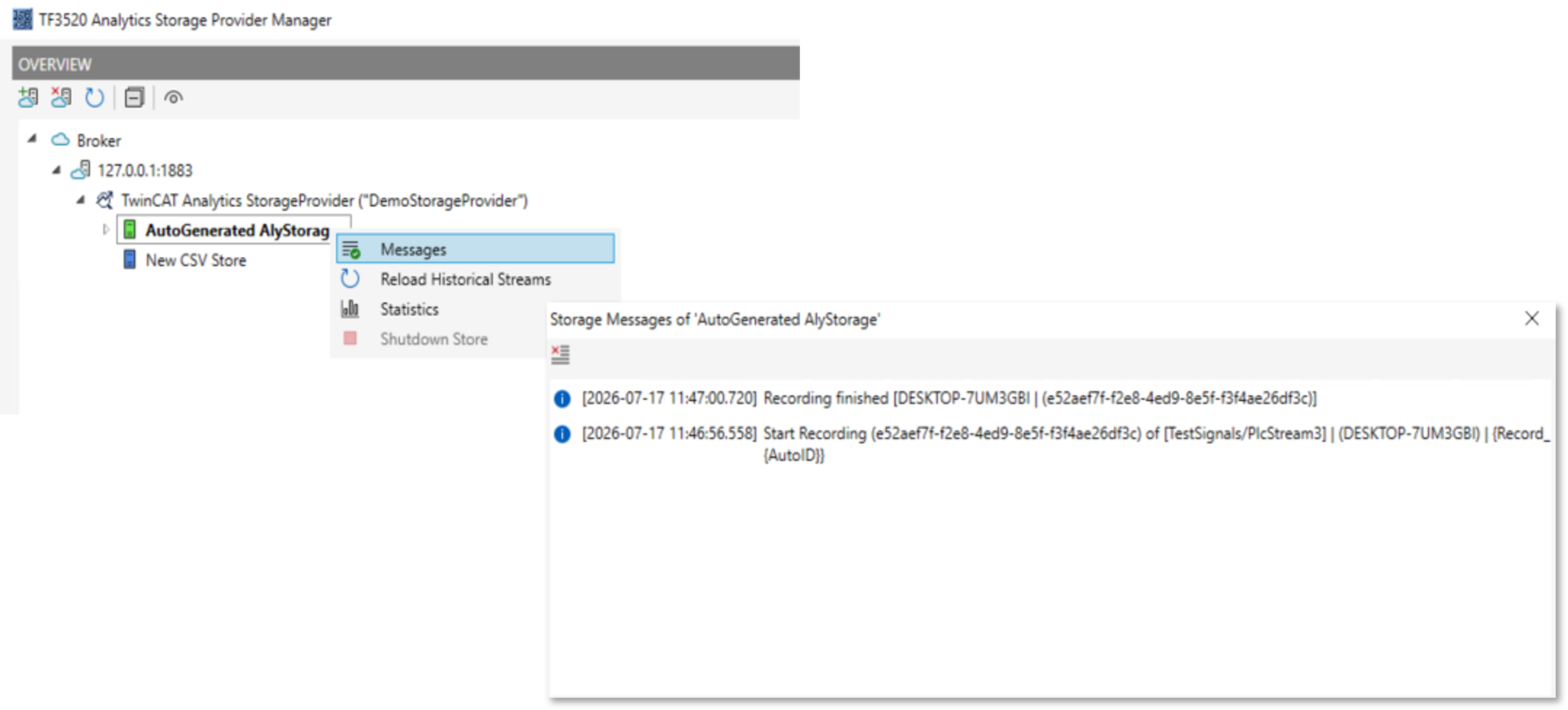

Viewing storage-specific messages
Each storage system also provides specific messages. To view these, you can also open the Messages window by right-clicking on the desired storage and selecting “Messages”.

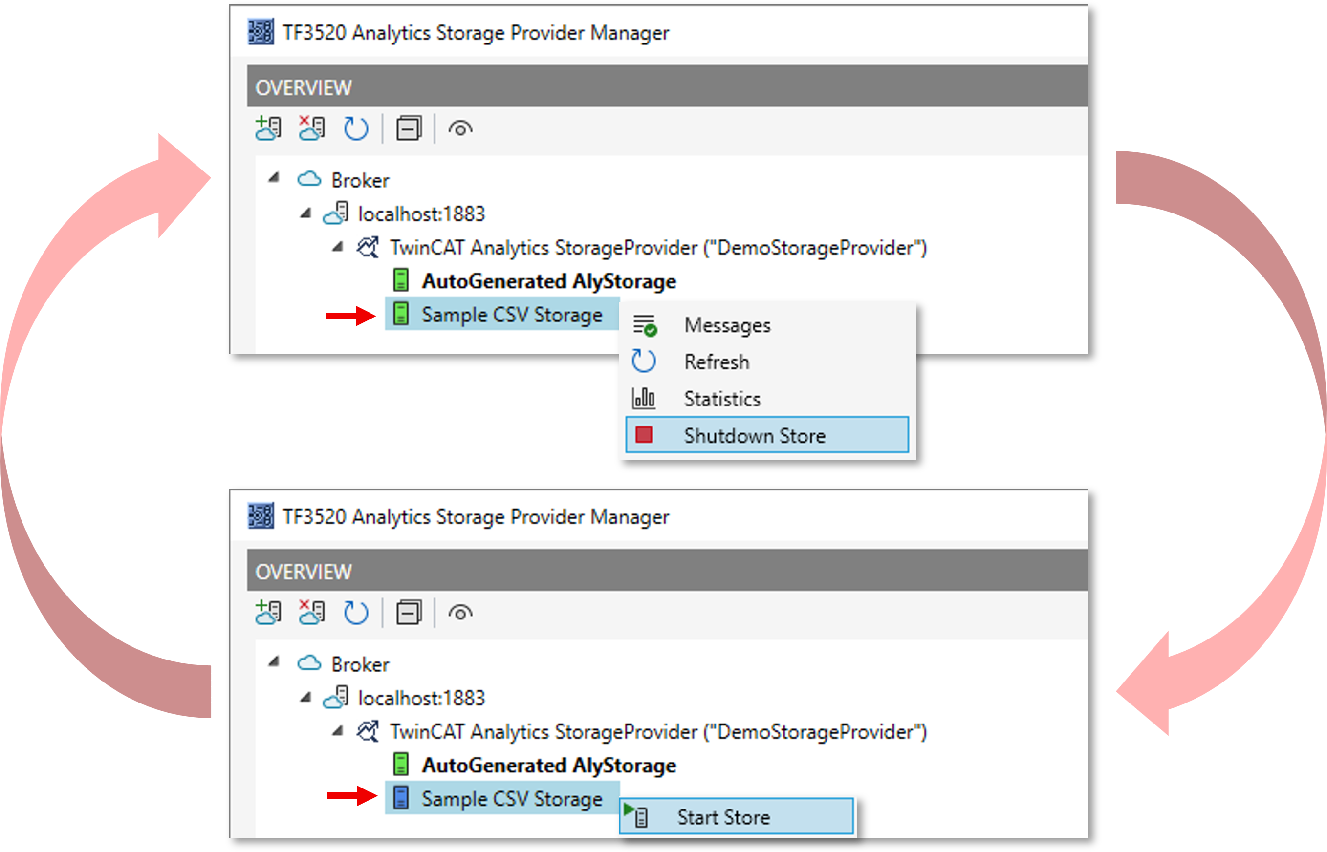

Starting and stopping storage systems
You can start and stop the respective storage instance by right-clicking. The default storage defined in the Configurator remains active at all times and is therefore exempt from this rule.

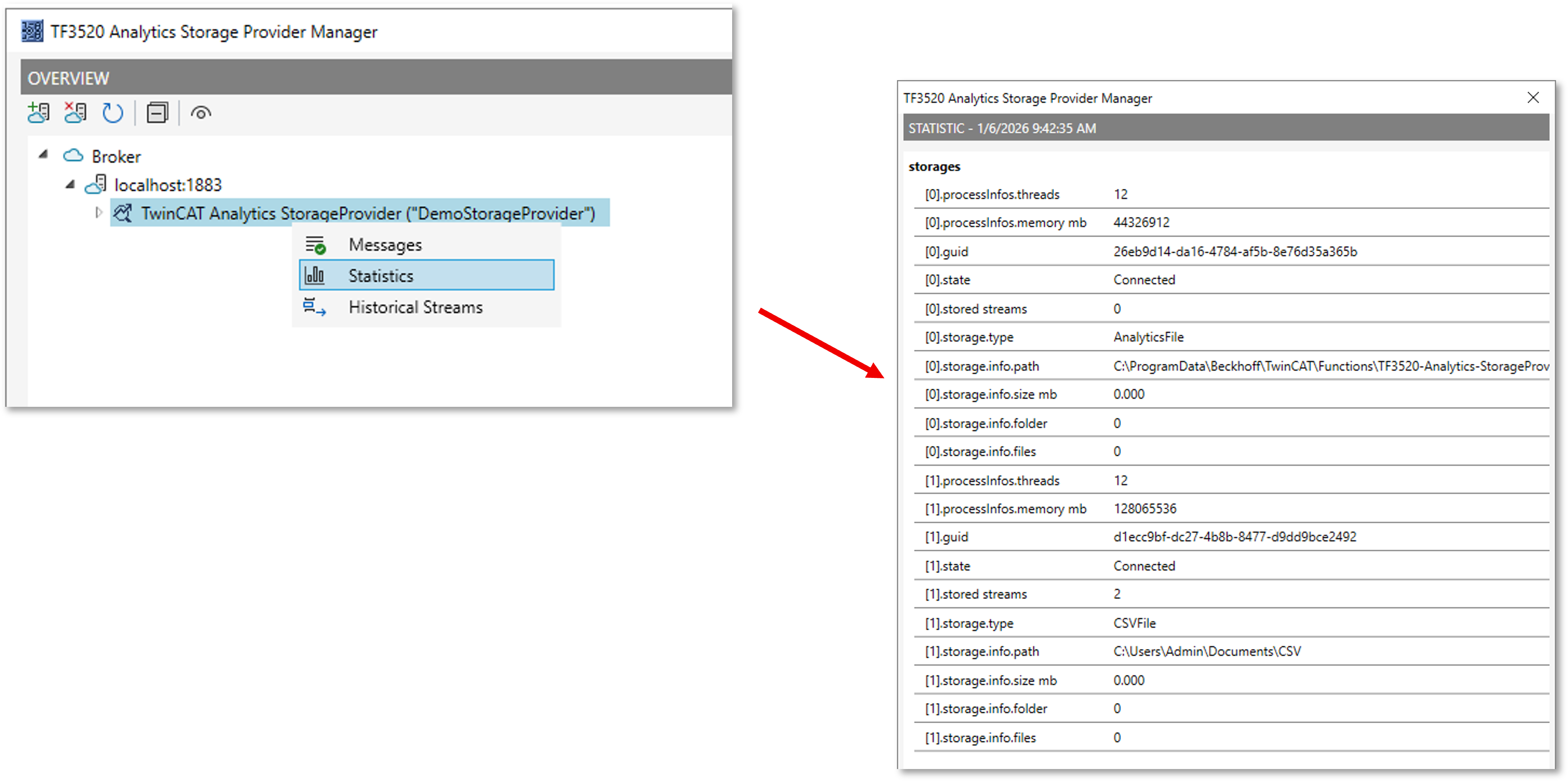

Viewing statistics
In addition to the messages, the Storage Provider also provides some statistics. You can view these by right-clicking on the desired Storage Provider and selecting “Statistics”.

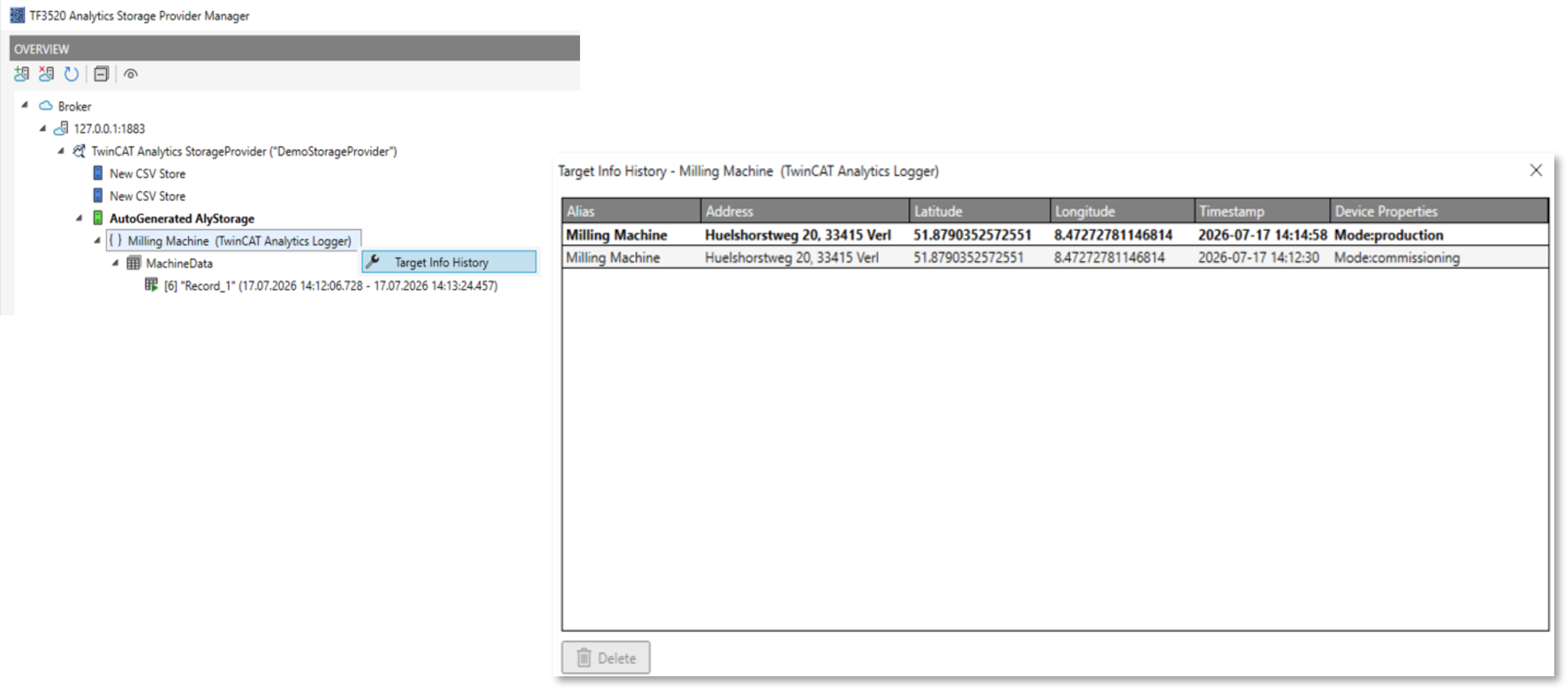

Viewing the history of target information
Starting with version 33.17.0, the Storage Provider also stores the history of the information provided by the target, such as system aliases and localizations. This information can be accessed by right-clicking -> Target Info History.

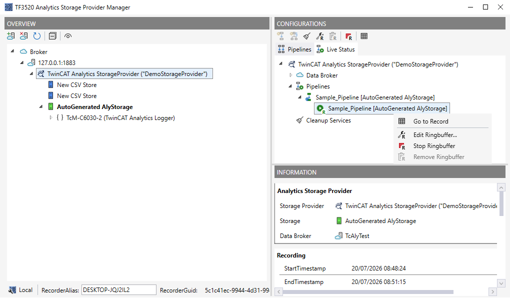

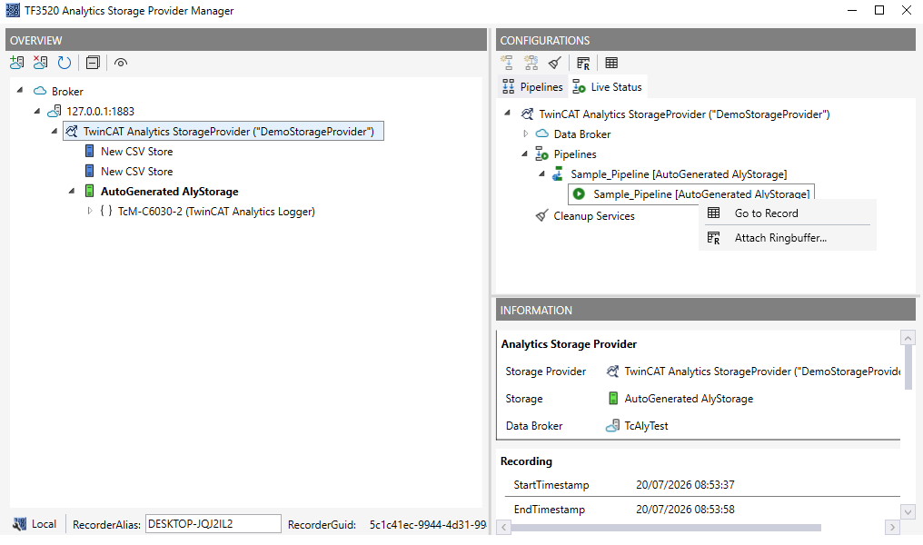

Adjusting ring buffers in live status
Starting with version 33.17.0, a pipeline’s ring buffer can also be modified at runtime. For example, a ring buffer can be added to a running pipeline at a later time. To do this, right-click on the pipeline and select Attach Ringbuffer. You can then configure the ring buffer.
Manager ("Recorder") 23:
Manager ("Recorder") 24:
In addition, the ring buffer can be started and stopped separately from the pipeline. The status icon next to the pipeline indicates whether the ring buffer is running or stopped.

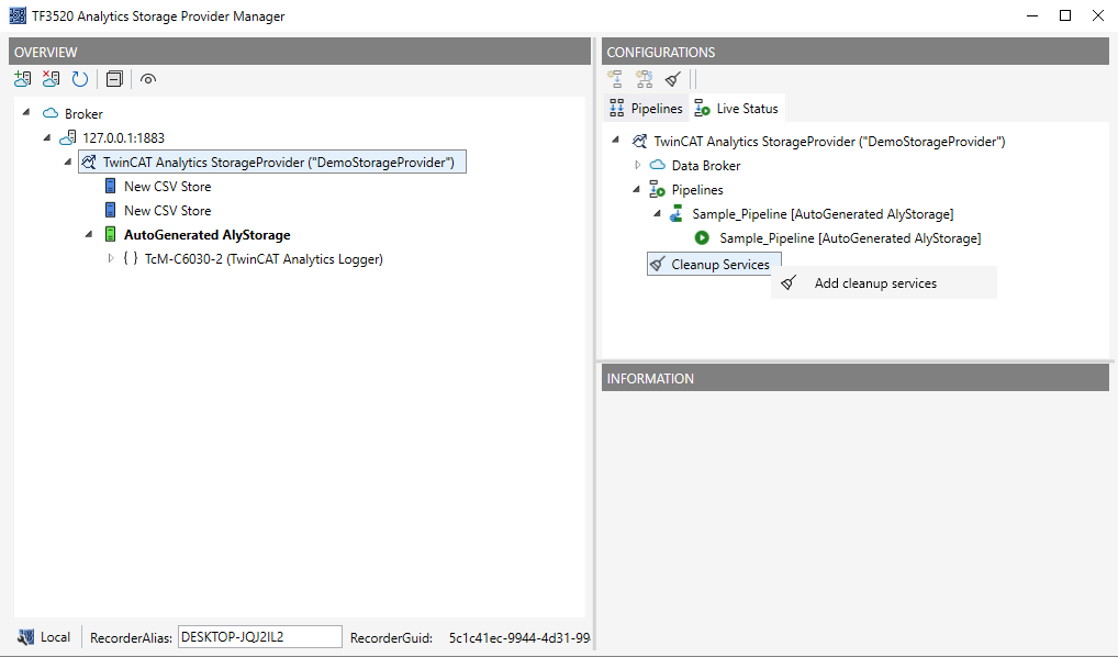

Manager ("Recorder") 25:

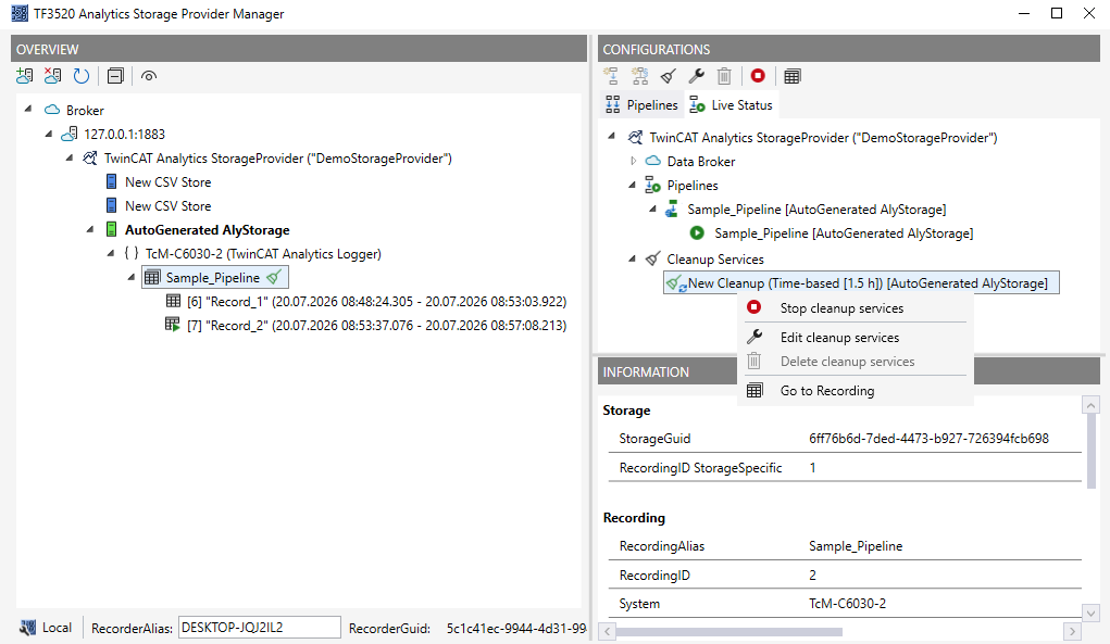

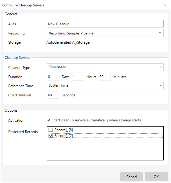

Configuring cleanup services in live status
Starting with version 33.17.0, cleanup services can also be configured in Live Status. These also feature a ring buffer function. Unlike the well-known record ring buffer, however, the cleanup service operates at the recording level rather than the record level. The cleanup service first considers all records that belong to a recording. This means that, if necessary, even completed or stopped records may be deleted or overwritten.
To add a new cleanup service, right-click “Cleanup Services” and click “Add” to create a new cleanup service. The corresponding configuration screen will then open.
Manager ("Recorder") 26:
Manager ("Recorder") 27:
You can configure the following parameters:
Alias
Display name for the cleanup service
Recording
Recording to which the cleanup service should apply
Cleanup Type
Cleanup Type
  • Time-based: A time interval defines the buffer size.
  • Data-based: An amount of data defines the buffer size (not available for all storage types).
Duration/Size
Size of the ring buffer
Reference Time (only for Timebased)
Reference time for the calculation basis
  • SystemTime: Current system time from the Storage Provider
  • DataTime: The most recent timestamp written to the recording.
DataTime is a particularly suitable option for event-based data or data with gaps. The most recently written timestamp is always used as a reference. If no new data is written over a certain period of time, the cleanup service will not overwrite any data during that time.
With SystemTime, on the other hand, the current system time is always used as a reference. In this case, older data is deleted even if no new data is written.
Check Interval
The time interval after which the cleanup service checks the data again
Activation
If this option is enabled, the cleanup service starts automatically as soon as the associated storage is started.
Protected Records
Selected records are excluded from the cleanup. This means that this data will not be overwritten or deleted.
Then click OK to save your changes. The cleanup service is now displayed under the “Cleanup Services” node. You can edit, start, stop, or delete it using the context menu.
