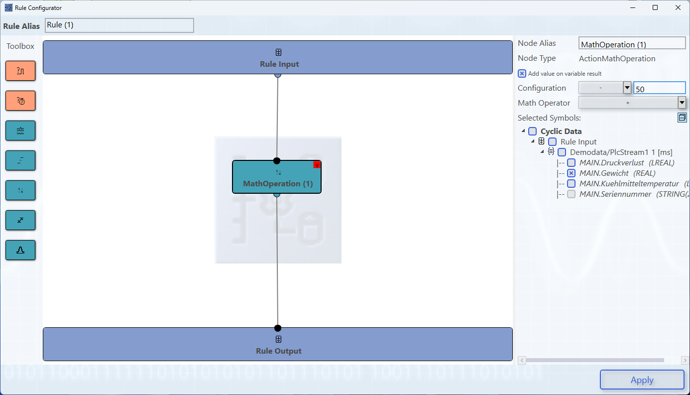

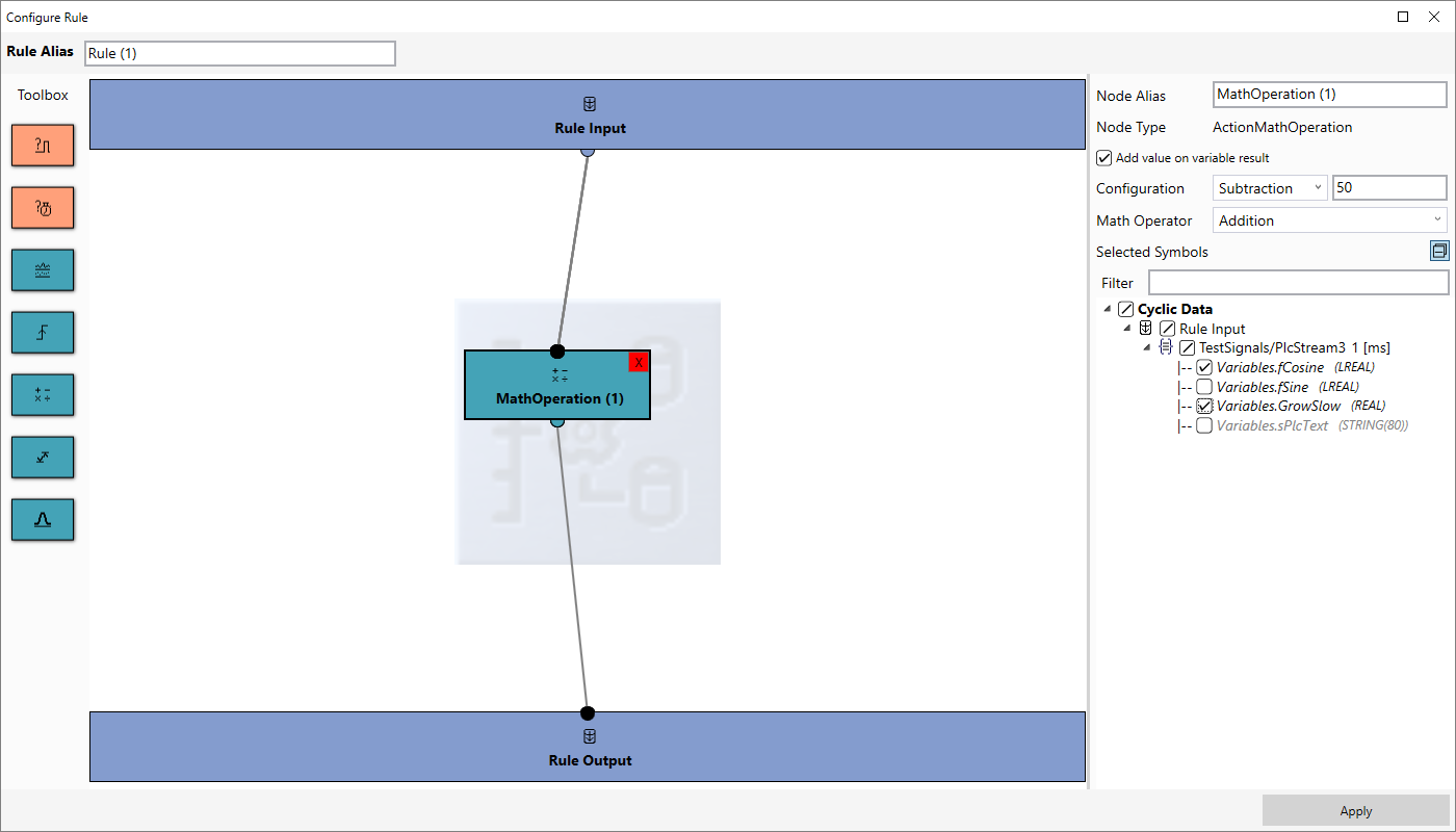

MathOperation
Symbols can be calculated with each other using the MathOperation block. The symbols to be calculated with each other can be selected under Selected Symbols. The operator can be selected under MathOperator. If the result is to be calculated with an additional constant value, activate the Add value on variable result checkbox. In the Configuration area, you can configure the operator and the constant value with which the result of the symbols is to be calculated.
The following symbol is provided:
- Result: Result of the calculation
