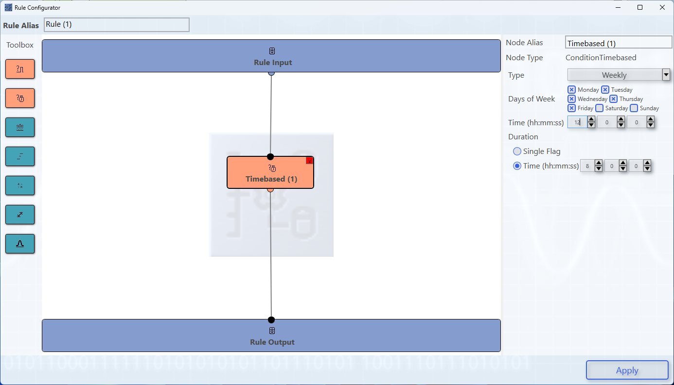

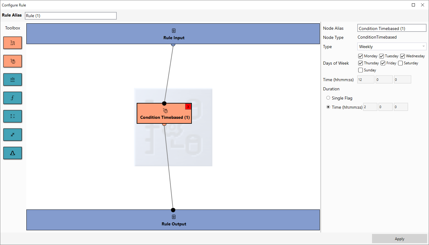

The Timebased-Condition can be used to filter within the data on a time basis. The time on which this is based is the respective timestamp of the data. The following configurations can be made:
- Type: Selection of the type of Timebased Condition. Three types are available
- Interval: The condition is fulfilled as soon as the interval is reached.
- Weekly: The condition is fulfilled on certain days of the week at a certain time.
- Monthly: The condition is fulfilled in certain months on a certain day at a certain time.
- Duration: Selection of how long the data should be forwarded once the condition is fulfilled.
- Single Flag: The data is forwarded once when the condition is fulfilled, i.e. as with a rising edge.
- Time: Alternatively, the data can also be forwarded for a specific time, which can be configured manually.
