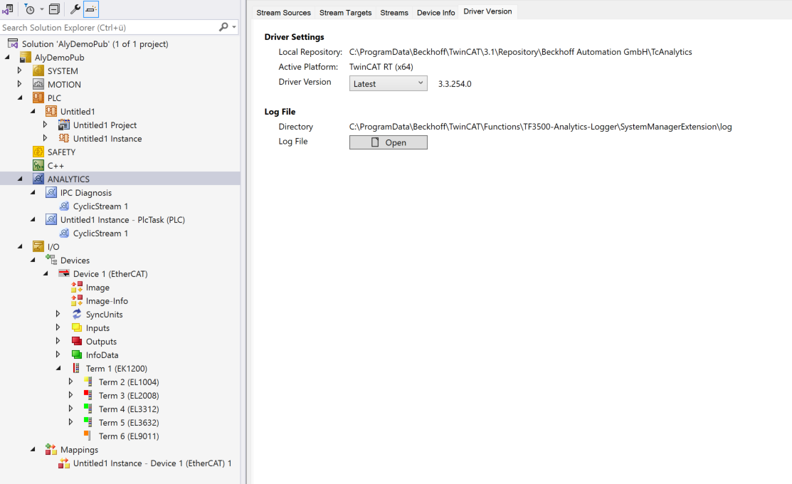

Driver Version
The last tab of the basic settings is about the driver versions that are used. The version selected here (default: Latest) is automatically downloaded to the target system (controller) when the TwinCAT configuration is activated. This applies to all operating systems under 4026, eliminating the need for additional installation in the form of packages on the target system itself.
Driver Version 1:
The log for the Analytics Logger System Manager extension can also be viewed here. Beckhoff Support may also ask you to provide this file in the event of support.
