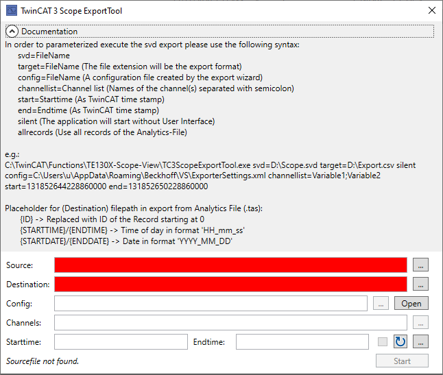

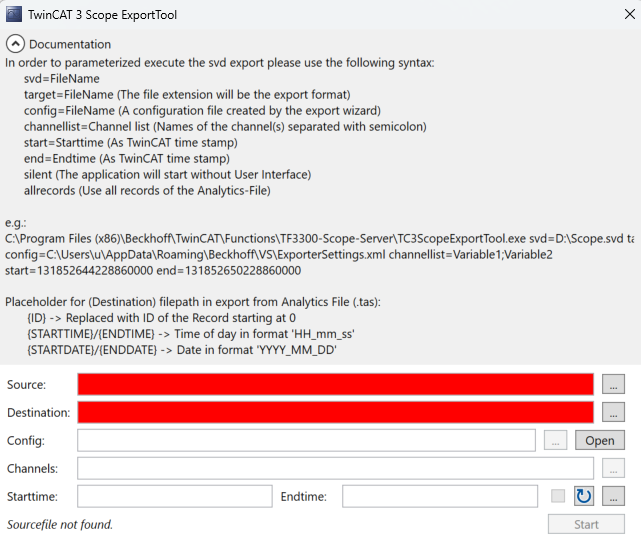

Automated export 1:
The TwinCAT 3 Scope ExportTool can also be used for export via a command line call, based on specified parameters. The interface shown here can be suppressed by entering the keyword "silent" in the command line. In this case the export is executed in the background.
To automate the export, the tool can be called from the PLC via NT_StartProcess.
Code sample with fixed strings and fbStartExport as an instance of NT_StartProcess:
fbStartExport(
    NETID:= '',
    PATHSTR:= 'C:\Program Files (x86)\Beckhoff\TwinCAT\Functions\TF3300-Scope-Server\TC3ScopeExportTool.exe',
    DIRNAME:= 'C:\Program Files (x86)\Beckhoff\TwinCAT\Functions\TE130x-Scope-View',
    COMNDLINE:= '"svd=c:\Scope Project.svd" target=c:\TestExport.csv silent',
    START:= bStart,
    TMOUT:= T#20S,
    BUSY=> ,
    ERR=> ,
    ERRID=> );
