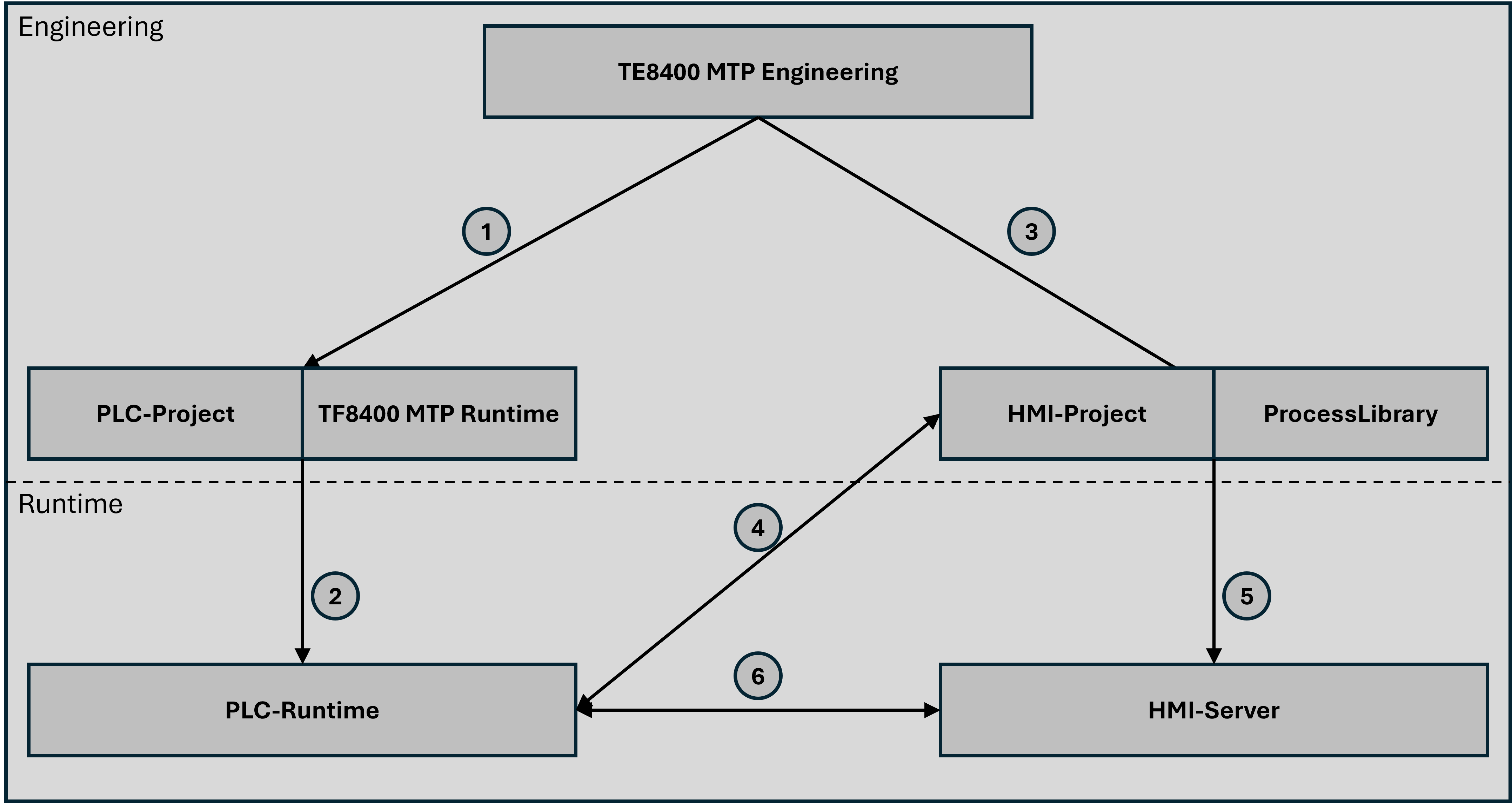

Generating PLC and HMI projects
You can use MTP Engineering to generate a PLC project and an HMI project from the objects in the module definition.
You can integrate these projects into an existing project or generate a new project. You can select the existing projects in the module properties under PLC Reference or HMI Reference.
- 1. Generate/integrate the PLC template (using the TF8400 MTP Runtime).
- 2. Activate the PLC project.
- 3. Generate/integrate the HMI project. (Using the
TwinCAT HMI Process Library) - By activating the PLC project beforehand, the HMI controls are automatically mapped to the function blocks in the PLC.
- 4. Use the Live View connection to test the project
- 5. Transfer the HMI project.
- The runtime for operating the project has been created
- 6. Use the runtime connection to operate the project.
