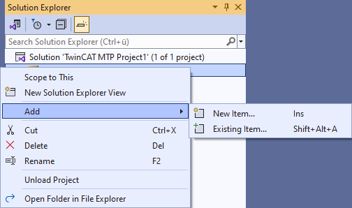

- 1. In the context menu of the MTP project, select Add->New Item.

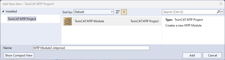

- 2. Click on Add to create an empty MTP module.
- The empty MTP module is created.
