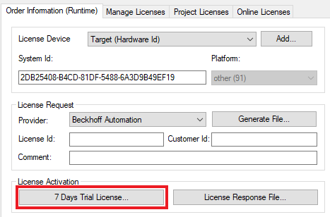

 - 5. Open the Manage Licenses tab. In the Add License column, check the check box for the license you want to add to your project (e.g. "TF4100 TC3 Controller Toolbox").
 - 6. Open the Order Information (Runtime) tab.
 - In the tabular overview of licenses, the previously selected license is displayed with the status “missing”.
 - 7. Click 7-Day Trial License... to activate the 7-day trial license.

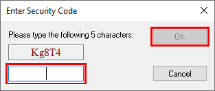

 - A dialog box opens, prompting you to enter the security code displayed in the dialog.
 - 8. Enter the code exactly as it is displayed and confirm the entry.
 - 9. Confirm the subsequent dialog, which indicates the successful activation.
