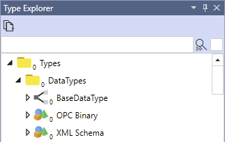

Type Explorer
The Type Explorer displays all data types from the currently loaded nodesets. Further actions are available via the toolbar and a textbox allows to search for nodes.
Type Explorer 1:
The numbers on each node represent the NamespaceIndex of a particular node and may be useful for easier identification of nodes.
