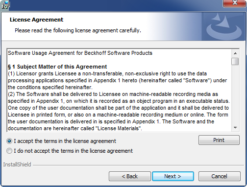

2. Accept the end user licensing agreement and click Next.
Installation 1:

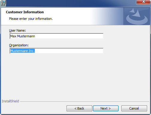

3. Enter your user data.
Installation 2:

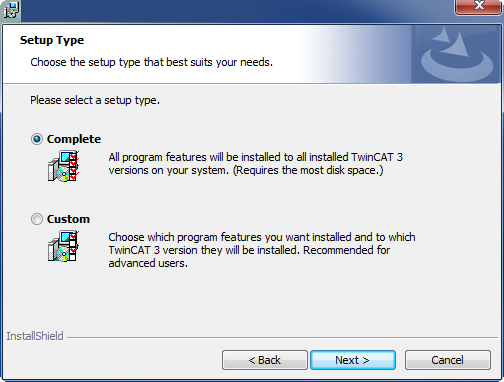

4. If you want to install the full version of the TwinCAT 3 function, select Complete as the installation type. If you want to install the TwinCAT 3 function components separately, select Custom.
Installation 3:

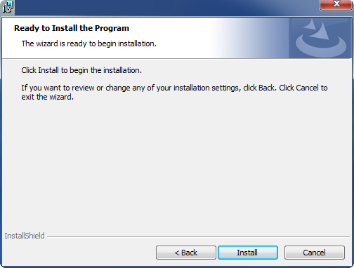

5. Click Next, then Install to start the installation.
Installation 4:

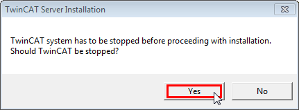

A dialog box informs you that the TwinCAT system must be stopped to proceed with the installation.
6. Confirm the dialog with Yes.
Installation 5:

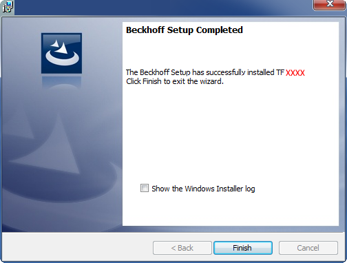

7. Click Finish to exit the setup.
Installation 6:
The TwinCAT 3 function has been installed successfully.
