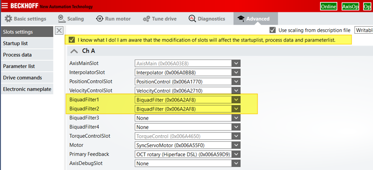

Filter slots for AX8000/AMP8000
Problem
The use of filters under AX8000/AMP8000 is not possible or the filters are calculated but not applied.
Solution
Activate the desired number of filters in the advanced settings of the drive. Also place a check mark in the higher-level category. The filter slots are only available after reactivating the Solution in the drive.
Filter slots for AX8000/AMP8000 1:
