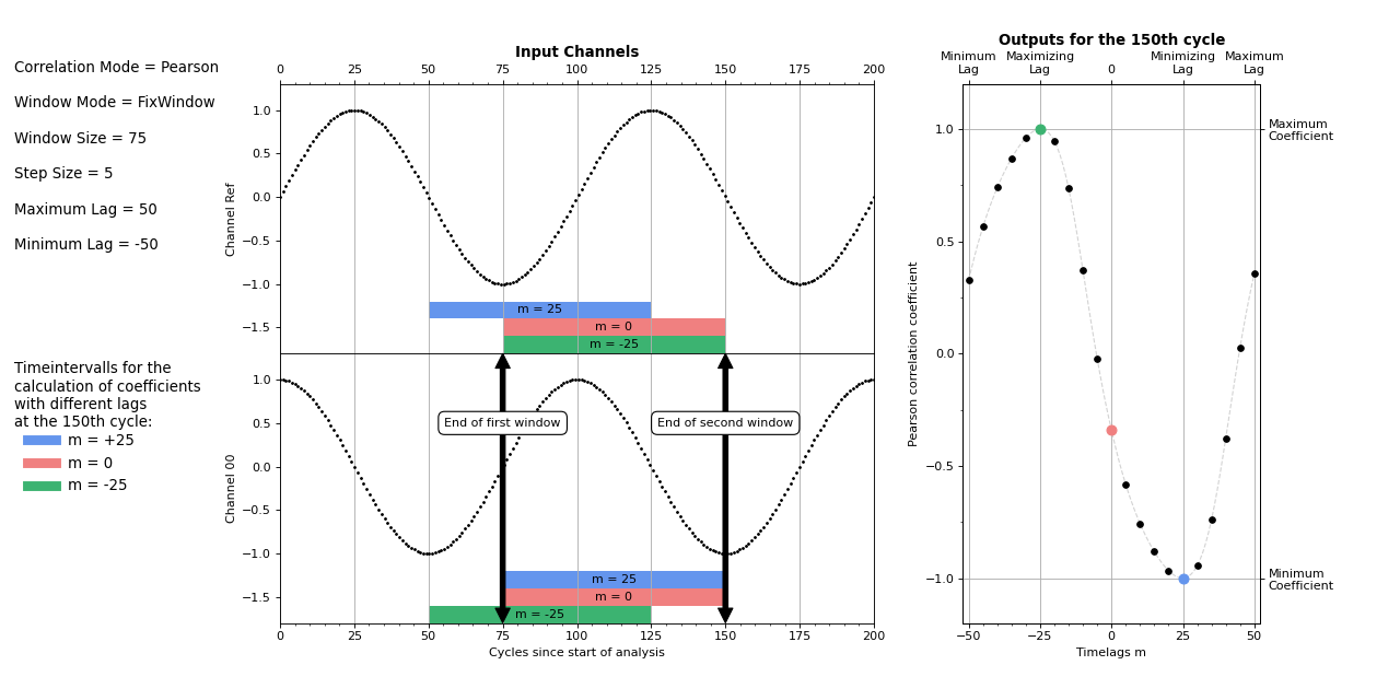

In the illustration, the output values of the function block for two signals (Channel Ref and Channel 00) for a given cycle (n = 150) are shown as an example of a configuration (Correlation Mode = Pearson, Window Mode = FixWindow, Window Size = 75, Step Size = 5, Maximum Lag = 50, Minimum Lag = -50). In the two left plots, the input signals Channel Ref and Channel 00 are shown over time. The right plot shows the discrete correlation function (the Pearson correlation coefficients in relation to m). Coefficients are shown for the shifts m = -50, -45, -40, -35, -30, -25, -20, -15, -10, -5, 0, +5, +10, +15, +20, +25, +30, +35, +40, +45, +50. These are output as an array in the function block. In addition to the two parameters Minimum Lag and Maximum Lag, the output values Minimizing Lag and Maximizing Lag are marked on the abscissa. The corresponding coefficients Minimum Coefficient and Maximum Coefficient, which also represent outputs of the function block, are marked on the ordinate. For the shifts m = -25, m = 0 and m =+25 in the plots of the input channels (left), the time ranges included in the calculation of the respective coefficient are highlighted in color. In the right plot, the corresponding points are colored.

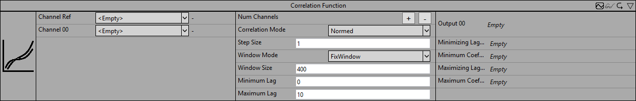

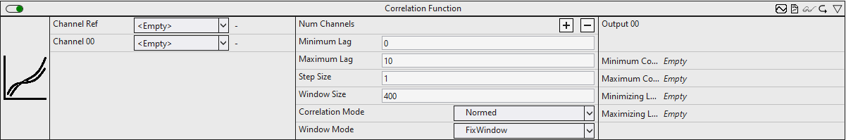

Configuration options
- Num Channels: The number of channels that are correlated with the reference signal. This can be set via Add/Remove Channel
- Maximum Lag: Specifies the maximum number of cycles by which the two signals are shifted to calculate the correlation to each other. This is a positive integer.
- Minimum Lag: Specifies the minimum number of cycles by which the two signals are shifted to calculate the correlation to each other. This is a negative integer.
- Step Size: Specifies by how many cycles the signals are shifted to calculate two consecutive correlation coefficients.
- Window Size: For the SlidingWindow and FixWindow window modes, specifies the number of cycles over which the coefficients are calculated. The windowing has no effect for the Continuous Window Mode and cannot be set. In SlidingWindow mode, Window Size values for all channels are buffered in addition to Maximum Lag values from the Reference Channel and Minimum Lag values for Channel 00 to Channel 0n. The size of the router memory should therefore be taken into account when setting these parameters.
