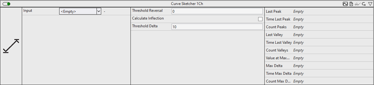

Configuration options
- Calculate Inflection: Boolean flag. Maxima of the rate of change are only identified if this flag is True. Otherwise, the values for Count Max Delta, Max Delta, Time Max Delta andValue at Max Delta will not be calculated.
- Threshold Reversal: threshold for identifying reversals. Reversals are only detected if their difference from the next reversal exceeds the value of Threshold Reversal.

- Threshold Delta: threshold for identifying Delta maxima. Maxima of the absolute difference of two successive values (delta) are detected only if the difference between successive deltas exceeds Threshold Delta.

Output Values
- Last Peak: Indicates the y-value of the last identified peak.
- Time Last Peak: Indicates the timestamp of the last identified peak.
- Count Peaks: Indicates the total number of counted peaks.
- Last Valley: Indicates the y-value of the last identified valley.
- Time Last Valley: Indicates the timestamp of the last identified valley.
- Count Valleys: Indicates the total number of counted valleys.
- Value at Max Delta: Indicates the y-value of the analyzed stream (input variable) that is led by the last detected maximum of delta. The value delta is the difference between Value at Max Delta and the value that reached one cycle before.
- Max Delta: Indicates the last identified local maximum of the absolute difference between two successive values in the input stream.
- Time Max Delta: This is the timestamp of Value at Max Delta.
- Count Max Delta: Indicates the total number of counted local maxima of delta.

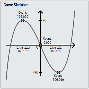

For the Curve Sketcher 1Ch algorithm, the following HMI controls are available for generating an Analytics Dashboard:
1. CurveSketcher control visualizes the output values Last Peak, Time Last Peak, Count Peaks, Last Valley, Time Last Valley, Count Valley, Last Delta, Time Last Delta and Count Delta as well as the input value of the data.
2. The Table Control visualizes all output values: Last Peak, Time Last Peak, Count Peaks, Last Valley, Time Last Valley, Count Valley, Value at Max Delta, Last Delta, Time Last Delta and Count Delta.
