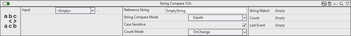

String Compare 1Ch
The String Compare 1Ch compares the input string with a reference string and counts the string matches. Therefore, case sensitivity can be taken into account or not and the count mode can be changed.
Configuration options
- Reference String: reference string for the comparison operation.
- String Compare Mode: enumeration for different string compare modes.
Equals: input string equals the reference string.
BeginsWith: input string begins with the reference string.
Contains: input string contains the reference string. - Case Sensitivity: if the checkbox is checked the input is case-sensitive, otherwise it is not case-sensitive.
- Count Mode: mode of the result counter.
OnChange: the counter counts every time the result changes to TRUE.
Cyclic: the counter increments every cycle when the condition is TRUE.
Output values
- String Match: TRUE, if the input string matches the reference string, otherwise FALSE.
- Count: Incremented when the output value is TRUE. The behavior depends on the parameter Count Mode.
- Last Event: Indicates the time of the last triggered event → the event can be dragged and dropped into the Scope chart to display it as a trigger-event
