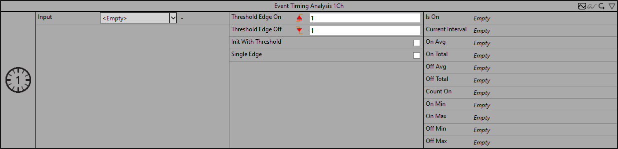

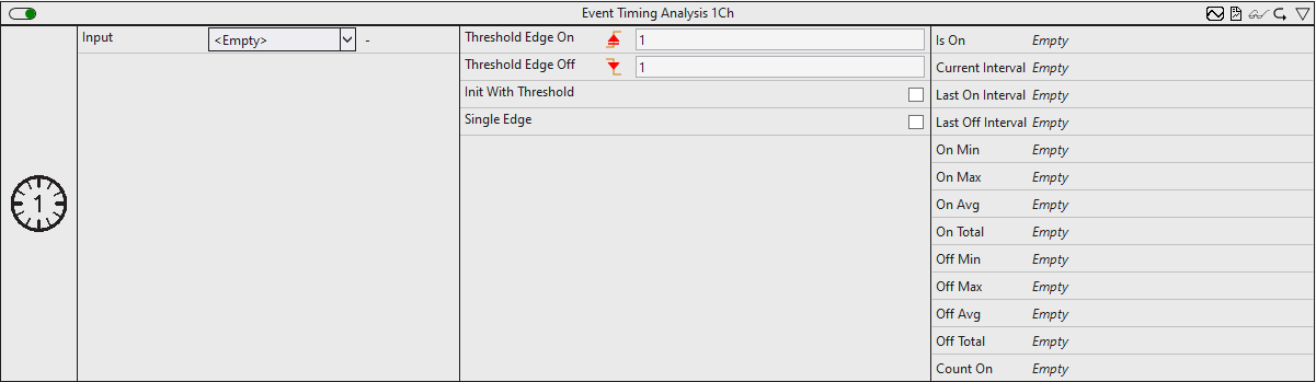

Configuration options
- Type of the edge: indicates whether the edge counter should react to a rising or a falling edge.
- Threshold On: threshold of the signal at the respective edge. The On event is triggered when the signal passes this threshold.
- Threshold Off: threshold of the signal at the respective edge. The Off event is triggered when the signal passes this threshold.
- Init With Threshold: if the value is TRUE, the algorithm uses a threshold to initialize the internal state instead of waiting for an edge.
- Single Edge: if the value is TRUE, the algorithm is executed only on the basis of the edges of the On event.
- Tolerance (optional): tolerance value for the Equal / NotEqual comparisons.
Output Values
- Is On: Shows TRUE within the time range between on-event and off-event, otherwise FALSE.
- Current Interval: Shows the time of the current interval.
- On Min: Shows the minimal time the "Is On"-value is TRUE.
- On Max: Shows the maximal time the "Is On"-value is TRUE.
- On Avg: Shows the average time the "Is On"-value is TRUE.
- On Total: Shows the total time the "Is On"-value is TRUE.
- Off Min: Shows the minimal time the "Is On"-value is FALSE.
- Off Max: Shows the maximal time the "Is On"-value is FALSE.
- Off Avg: Shows the average time the "Is On"-value is FALSE.
- Off Total: Shows the total time the "Is On"-value is FALSE.
- Count On: Counts the amount of raised on-events.

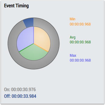

1. The EventTiming control visualizes the output values Is On, Count On, Current Interval, On Min, On Max, On Avg, On Total, Off Min, Off Max, Off Avg and Off Total.
