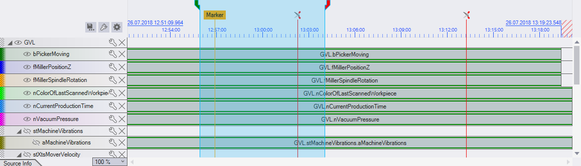

| The blue area lies above the tracks and represents which data is displayed in the chart. Also, the selected area is used for some toolbar functions. The red and green areas can be moved to increase or decrease the selection. If clicked between the red and green area, the selected area can be moved. On the left and right edges, the selection can snap. This happens near marker and track ends. To ignore the snap function, the Alt key can be pressed while moving. The selection cannot be smaller than 10 values. |
| Markers are displayed in the track as well as in the chart. In the tracks, markers can be renamed by clicking on the text and markers can be removed by right-clicking. The markers that have no text but scissors are special markers that can be used for elimination. |
| The timeline has the start time marked at the left end. Markers then follow at even intervals, indicating the time present there. |
| At the right end of the timeline is a marker for the end time. The end time will be equal to the start time plus the number of samples from the track with the fewest samples times the cycle time. If the number of samples in the tracks differs, a red dashed area is displayed behind the end time marker. This area is not exported, because there would not be data for all tracks. |
Tracks Container | In the lower part the tracks are displayed, where the display of the data from the tracks starts at the start time and before that the new symbolism is displayed. |

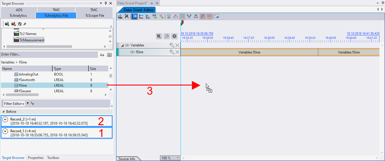

Add via drag and drop

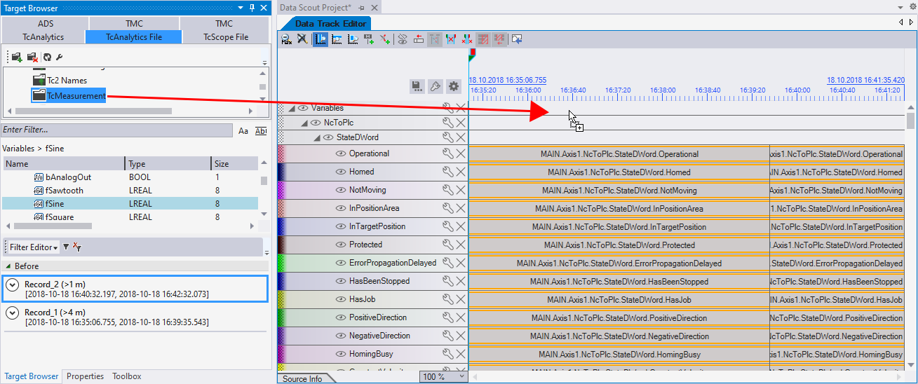

The tracks of a Data Track Editor are displayed in a separate area. This is empty at the beginning and can be filled using the Target Browser.
When one or more symbols are selected from the Target Browser and dragged into the empty area of the Track Editor, a new Container Track is created. To the new Container Track all selected symbols will be added as tracks.

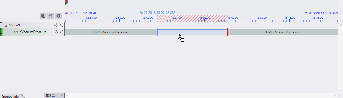

If a symbol is dragged onto the data area of a Container Track, a new track is created below this container.
When dragging to a Data Track, a new data element can be added to that track. However, this is only possible if the symbol to be added is compatible with the track. No structure can be drawn on a track with primitive data types.

If structures or arrays are to be added, this can happen as with symbols with primitive data type. However, Container Tracks are created for the upper elements of structures and arrays.
Automatic merging
To more easily merge symbols with the same structure, such as in an Analytics File with multiple records, when dragging multiple symbols onto a container or the empty area of the tracks, the system checks if the symbolism is the same. As soon as this is detected, a message appears that it is possible to add the symbols to the already existing tracks.
If this query is answered with Yes, the added symbols will be appended as a data element to the matching existing track. If the query is answered with No, new tracks are added.
The same result can be achieved by dragging each symbol individually onto the already existing track.

If the order of existing tracks or data elements is to be changed, this can be done with drag and drop. Data elements can be moved on the whole surface and tracks on the left border
. To do this, the area must be clicked with the left mouse button and moved with the mouse button pressed.
Data elements can be rearranged in the same track or moved to another track. When data elements are dragged onto container tracks or into the track editor, a new track is created. Also, the data element must be compatible with the track it is moved to e.g. a data element with multiple symbols from a multi track cannot be moved to a single track.
