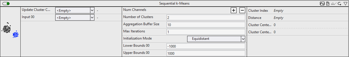

- Num Channels: Determines the number of input channels.
- Number of Clusters: Defines the number of clusters.
- Aggregation Buffer Size: Specifies the size of the aggregation buffer and thus the number of cycles after which the cluster centers are updated. The input values of these cycles are stored internally (in the aggregation buffer). The default value for this parameter is 10.
- Max Iterations: Specifies how often to iterate over the values in the aggregation buffer. The default value for this parameter is 1.
- Initialization Mode: Specifies the way in which the cluster centers are initialized:
- Random: The cluster centers are set randomly within the limits set by the Lower Bounds and Upper Bounds.
- Equidistant: The cluster centers are distributed equidistantly in the range of values defined by the Lower Bounds and Upper Bounds.
- Values: The cluster centers are initialized with the values set by the array Initial Cluster Centers.
- Initial Cluster Centers: For the initialization mode Values the values for the initial cluster centers are set here. The values for the individual clusters are set line by line. That is, the number of matrix rows corresponds to the Number of Clusters and the number of matrix columns corresponds to the Number of Channels. The first row contains the values for the first cluster for each input channel, and so on.
- Lower Bounds: For the modes Random and Equidistant the lower limits for the individual input channels are set.
- Upper Bound: For the modes Random and Equidistant the upper limits for the individual input channels are set.
