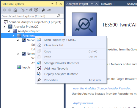

A network can be added directly from the Analytics Project home page or from the context menu.

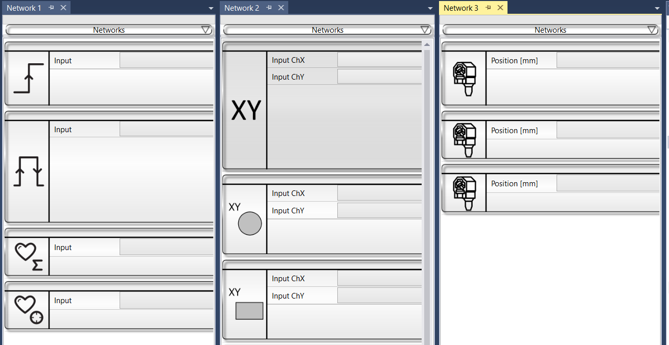

Each network is displayed in an individual tab. In this way, the networks can be displayed separately, i.e. side by side or one above the other.
Furthermore, you have the option to rename the networks (F2 on the selected network element in the Solution Explorer) to create networks for different machines, machine parts or other content-related connections, for example.
