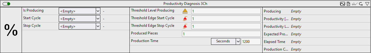

Configuration options
- Type of the Edge: Specifies whether the algorithm should respond to a rising or falling edge. Can be configured individually for each threshold.
- Threshold Level Producing: Threshold of Input Producing at the respective edge. The Production Time Interval starts when the signal passes this threshold.
- Threshold Edge Start Cycle: Threshold of Input Start Cycle at the respective edge. The production cycle starts when the signal passes this threshold.
- Threshold Edge Stop Cycle: Threshold of Input Stop Cycle at the respective edge. The production cycle stops when the signal passes this threshold.
- Produced Pieces: Target value for pieces produced during the configured time interval (Production Time).
- Production Time: Time interval of the production time. It can be configured in days, hours, minutes or seconds.
- Tolerance (optional): Tolerance value for the Equal / NotEqual comparisons.
