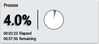

Standard HMI Controls
For the Lifetime Analysis 1Ch algorithm, the following HMI controls are available for generating an Analytics Dashboard:
1. The Process control visualizes the output values Elapsed Lifetime and Remaining Lifetime.
2. The Table Control or Multivalue Control visualizes all output values: Elapsed Lifetime, Remaining Lifetime.
