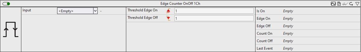

The Edge Counter On Off 1Ch counts the amount of raised on- and off-events. An on-event is raised when the signal of the input channel passes the configured edge at a specific on-threshold and an off-event is raised when the off-threshold is passed by the same signal.
Configuration options
- Type of the edge: Specifies whether the edge counter should respond to a rising or falling edge.
- Threshold On: Threshold of the signal at the respective edge. The On event is triggered when the signal passes this threshold.
- Threshold Off: Threshold of the signal at the respective edge. The Off event is triggered when the signal passes this threshold.
- Tolerance (optional): Tolerance value for the Equal / NotEqual comparisons.
Output values
- Is On: Indicates TRUE within the timespan between the On event and the Off result, otherwise FALSE.
- Edge On: Indicates TRUE on a rising edge.
- Edge Off: Indicates TRUE on a falling edge.
- Count On: Counts the number of triggered On events.
- Count Off: Counts the number of triggered Off events.
- Last Event: Indicates the time of the last triggered event → the event can be dragged and dropped into the Scope chart to display it as a trigger-event.
