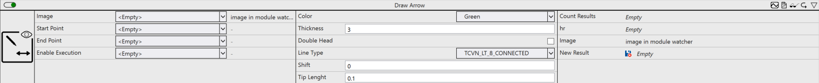

Draw Arrow
Draw a line with an arrowhead in the picture.
Configuration options
- Color: Color of the arrow.
- Thickness: Line width.
- Double Head: Draws an arrow on each side of the line.
- Line Type: (Optional) Line type.
- Shift: (Optional) Decimal bits of the coordinates (bit shift).
- Tip Length: (Optional) Length of the arrowhead as a proportion of the line length.
Output values
- Count Results: Is incremented when a new result is provided.
- hr: HRESULT error code that outputs the result of the processing.
- Image: Initial image of the algorithm.
- New Result: (Optional) TRUE if a new result is provided.
