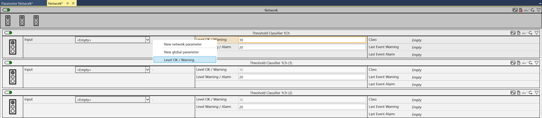

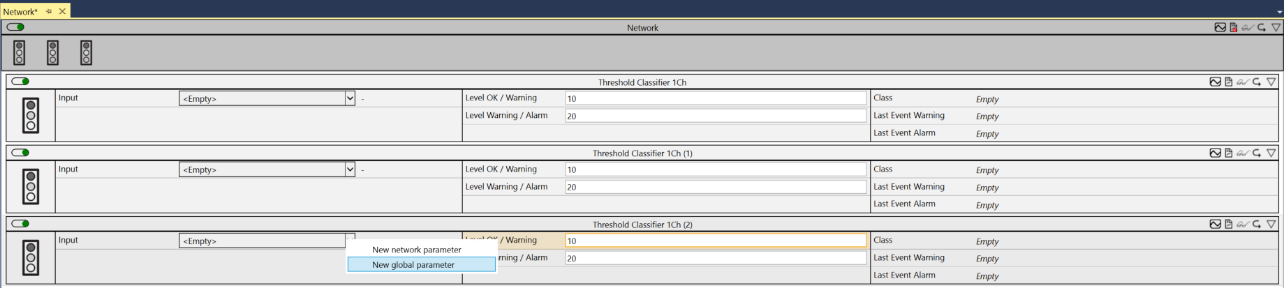

1. To create a new global parameter, right-click on an existing parameter and select the New global parameter option.
Global parameters 1:
2. Existing global parameters can then be selected via the same context menu on other algorithms.
