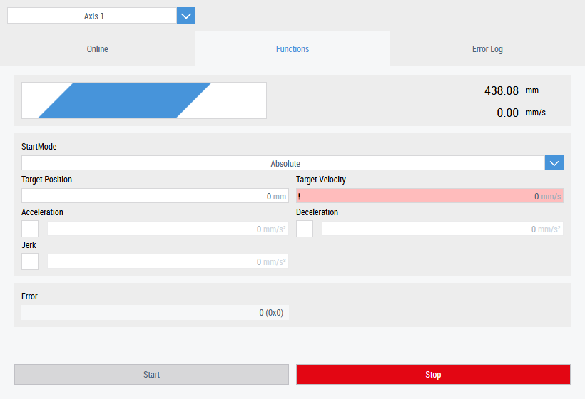

Functions:
Various axis functions can be executed in the Functions tab. Only "Absolute" is available for an axis in PLC mode. For an axis that is connected via the NC, the same functions are available as in the System Manager. This allows functions such as "Reversing Sequence" to be used to move an axis back and forth between two positions. This could be interesting for optimizing the axis or for test movements. Depending on the function selected, the associated parameters under the dropdown will change.

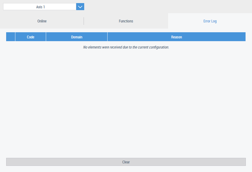

Error Log:
The axis errors are displayed in the Error Log tab. The display of axis errors enables quick countermeasures to be taken.
