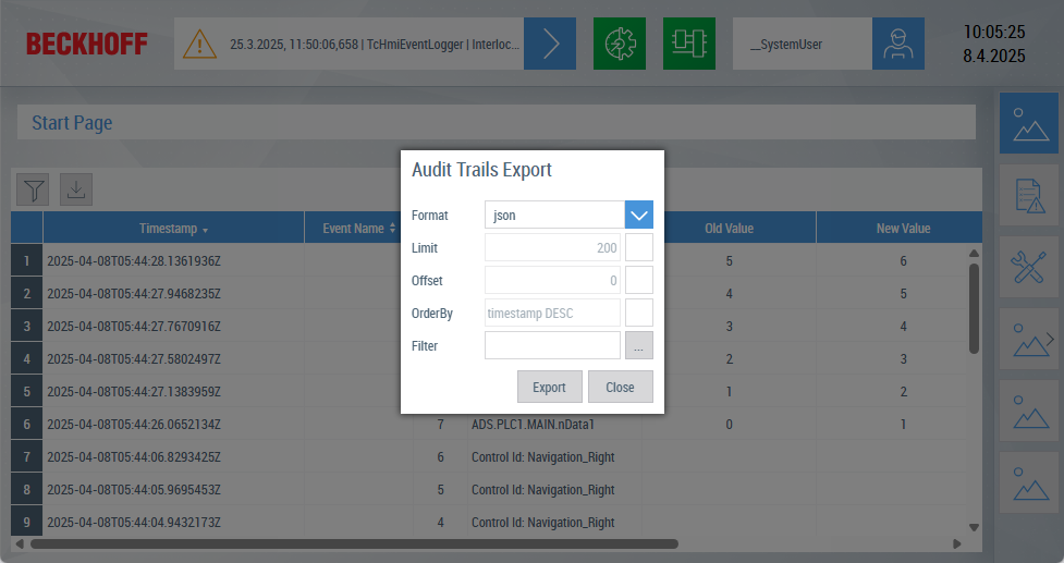

Export
The recorded values can be exported as JSON or CSV via the export function.
Format
- Selection of the export format: JSON or CSV.
Limit
- Limitation of exported entries.
Offset
- Offset from which the data is exported.
OrderBy
- Sort the entries "ASC" in ascending order and "DESC" in descending order for the corresponding column.
Filter
- Filter settings for the data to be exported.
