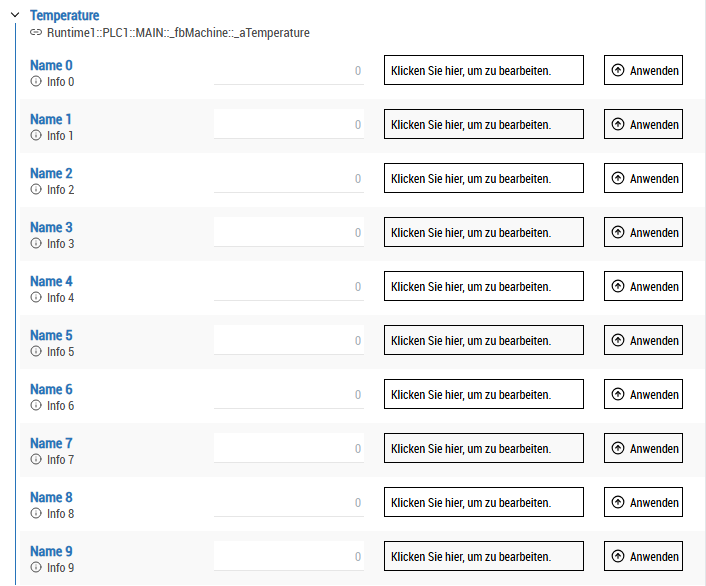

Array of a variable
The names of the individual array entries can be changed using Name and InfoArrayIndex. By default, the index is used as the name.
FUNCTION_BLOCK FB_Machine
    {attribute 'TcHmiSystemEng.Parameter.Name' := 'Temperature'}
    {attribute 'TcHmiSystemEng.Parameter.NameArrayIndex' := 'Name [[index]]'}
    {attribute 'TcHmiSystemEng.Parameter.InfoArrayIndex' := 'Info [[index]]'}
    _aTemperature         : ARRAY [0..9] OF REAL;
