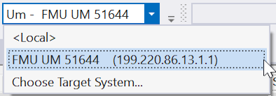

Starting runtime and simulation
After successfully importing the FMU, you can start the simulation. During the simulation start, the TwinCAT Runtime is initialized within the FMU and can then be selected as a target in TwinCAT 3.1. Since multiple runtime FMUs can be executed in different processes, the respective process ID is displayed after the UM runtime. In the image below, the process ID is therefore 51644. The Runtime FMU can be executed only once within a process.
