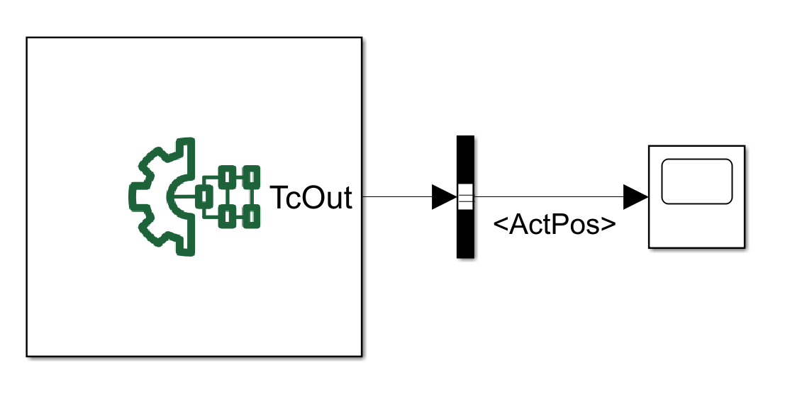

In Simulink®, the FMU Block is used for the FMU import. A Bus selector and a Scope Block are also used in this minimal example. The inputs and outputs of the FMU are interpreted as bus signals in Simulink®, so the bus object must also be created with the command fmudialog.createBusType before the first simulation start.
fmudialog.createBusType('model/FMU')
The resulting block diagram in Simulink® is shown in the figure below:
Importing FMU 1:
