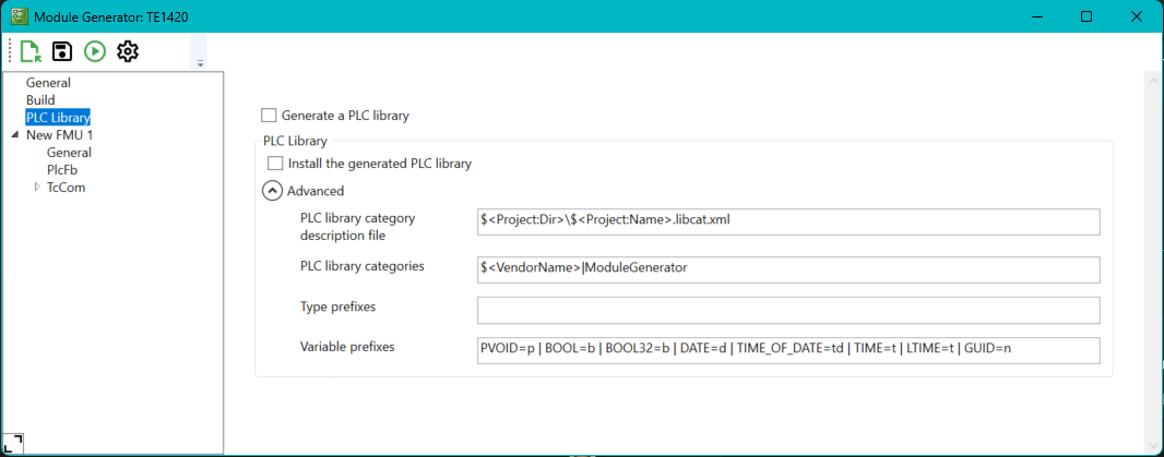

'PLC Library' tab
You set whether the FMI project should also be created or installed as PLC library under the PLC Library tab.
Setting | Meaning | Command line parameters |
Generate a PLC library | Setting whether a PLC library should be created. | --Project.GeneratePlcLibrary Default: "false" |
Install the generated PLC library | Setting whether the generated PLC library should also be installed. | --Project.InstallPlcLibrary Default: "false" |
There are also the following extended parameters, which are collapsed by default and do not normally need to be adjusted.
Setting | Meaning |
PLC library category description file | Path to the description file of the PLC library categories |
PLC library categories | PLC library categories of the library to be generated |
Type prefixes | Definition of type prefixes |
Variable prefixes | Definition of variable prefixes |
