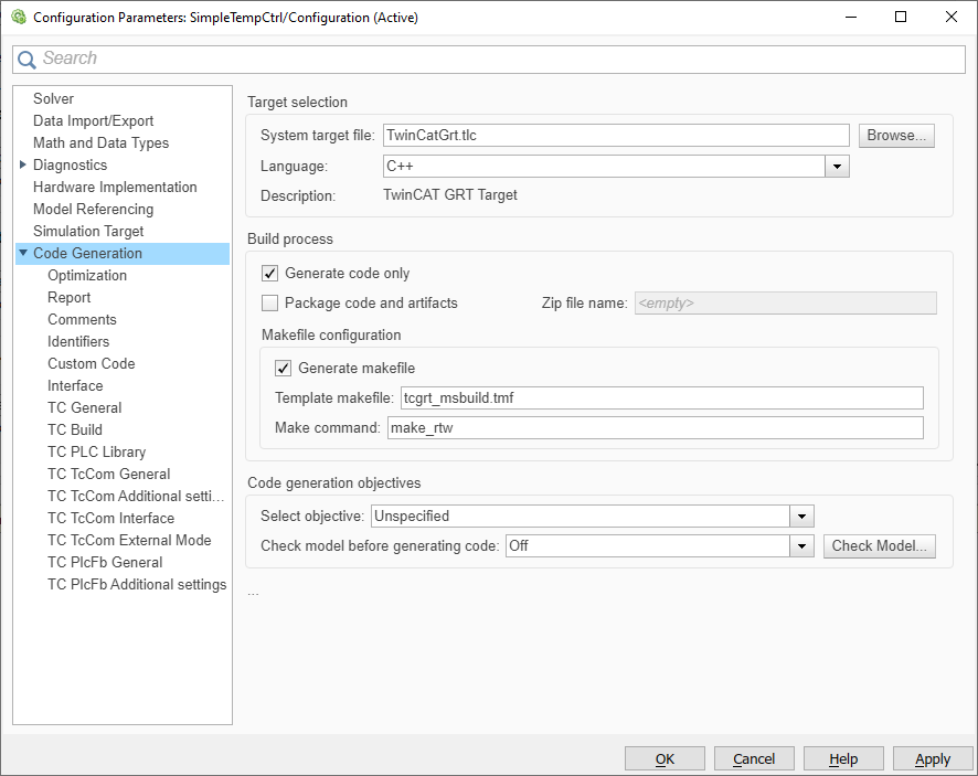

Parameterization of the code generation in Simulink®
Within Simulink® a large number of settings can be made for the configuration of the TwinCAT objects to be generated (TcCOM and function blocks). For this purpose the tree structure under Code Generation is extended by several entries (see entries starting with TC) as soon as you have selected the TwinCatGrt.tlc as System target file.

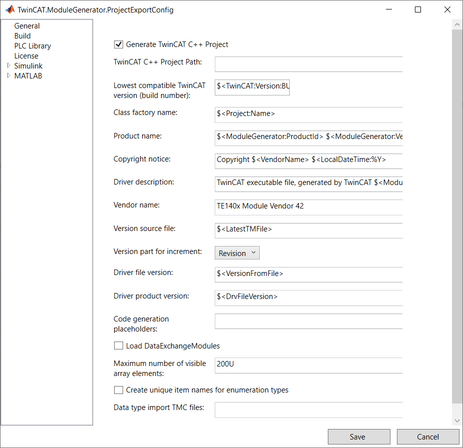

To change the default settings of the TwinCAT target, you can access a dialog in the MATLAB® Console as follows:
TwinCAT.ModuleGenerator.Settings.EditHere you are offered various entries that you can store as default values.
Accept changes
- 1. Enter the new default settings in the dialog box.
- 2. Confirm with the Save button.
- 3. Restart MATLAB®.
- The changes have been adopted.
