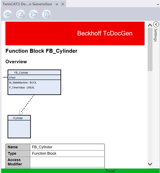

Documentation preview
You can display a preview of the documentation for elements that belong to the PLC.
To create the preview, proceed as follows:
- 1. Right-click the desired item in the Solution Explorer.
- 2. Select the item Generate Documentation Preview.
- The preview of the generated document opens in a separate window in TwinCAT.
Update preview
The preview of the generated document can be updated in the preview window.
- 1. To do this, click the Update preview button.
- The preview will be updated immediately.
