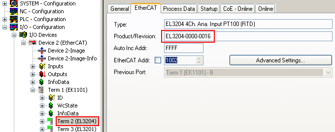

The ESI device description is stored locally on the slave and loaded on start-up. Each device description has a unique identifier consisting of slave name (9 digits) and a revision number (4 digits). Each slave configured in the System Manager shows its identifier in the EtherCAT tab (device identifier from name EL3204-0000 and revision -0016
The configured identifier must be compatible with the actual device description used as hardware, i.e. the description which the slave has loaded on start-up (in this case EL3204). Normally the configured revision must be the same or lower than that actually present in the terminal network.

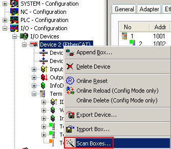

The simplest way to ascertain compliance of configured and actual device description is to scan the EtherCAT Boxes in TwinCAT mode Config/Freerun. Scan the subordinate field by right-clicking on the EtherCAT device in Config/FreeRun mode:

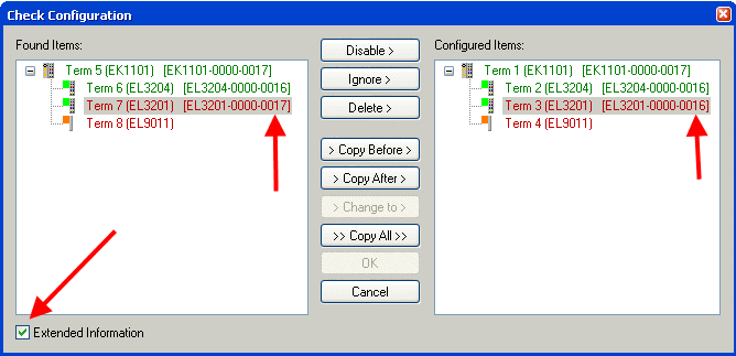

If the found field matches the configured field, the display shows: Configuration is identical
otherwise a change dialog for entering the actual data in the configuration.
In this example, an EL3201-0000-0017 was found while an EL3201-0000-0016 was configured. In this case the configuration can be adapted with the Copy Before button. The Extended Information checkbox must be set in order to display the revision.

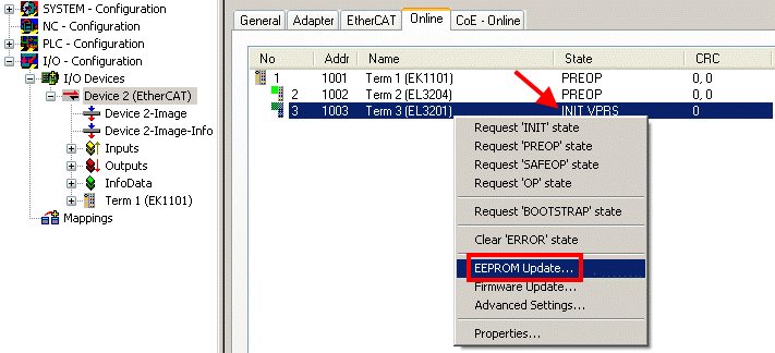

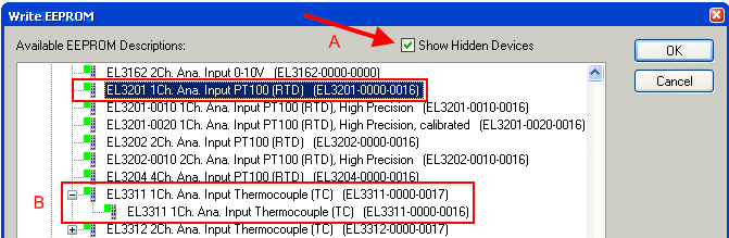

 - Right-click on the slave in the Online tab leads to the dialog EEPROM Update:
In the following dialog the new ESI description is selected. The checkbox Show Hidden Devices shows also older, normally hidden outputs of a slave:
A progress bar in the System Manager shows the progress - first writing, then verifying.

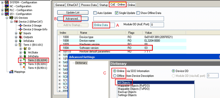

The TwinCAT System Manager shows the version of the controller firmware if the master can access the slave online. Click on the E-bus terminal whose controller firmware you want to check (in the example terminal 2 (EL3204)) and select the tab CoE Online (CAN over EtherCAT).
![]()  | CoE Online and Offline CoE
In the following dialog the FW state of the marked EL3204 is displayed in CoE entry x100A with 03:
In (A) TwinCAT 2.11 shows that the Online CoE directory is currently displayed. If this is not the case, the online directory can be loaded through the Advanced Settings (B) by Online and double-clicking All Objects.

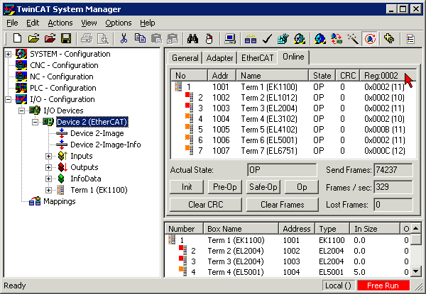

The TwinCAT System Manager indicates the FPGA firmware version. Click on the Ethernet card of your EtherCAT segment (Device 2 in the example) and select the Online tab.
The Reg:0002 column indicates the firmware version of the individual EtherCAT devices in hexadecimal and decimal representation.

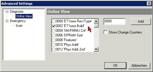

If the Reg:0002 column is not displayed, right-click the table header and select Properties in the context menu.
The Advanced Settings dialog appears where the columns to be displayed can be selected. Under Diagnose/Online View select the '0002 ETxxxx Build' checkbox in order to activate the FPGA firmware version display.

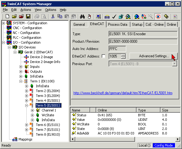

In the TwinCAT System Manager select the terminal for which the FPGA firmware is to be updated (in the example: Terminal 5: EL5001) and
click the Advanced Settings button in the EtherCAT tab.

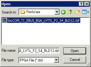

The Advanced Settings dialog appears. Under ESC Access/E²PROM/FPGA click on Write FPGA button.
Select the file (*.rbf) with the new FPGA firmware, and transfer it to the EtherCAT device.

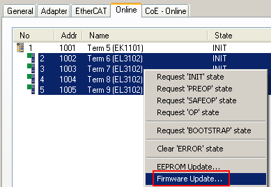

Simultaneous updating of several EtherCAT devices
The firmware of several devices can be updated simultaneously, as well as the ESI description. The prerequisite for this is that the same firmware file/ESI applies to these devices.
Select the required slaves and carry out the firmware update in BOOTSTRAP mode as described above.
