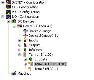

1. Integration of the EL6631-0010 into the EtherCAT network
Insert the EL6631-0010 into your TwinCAT project.

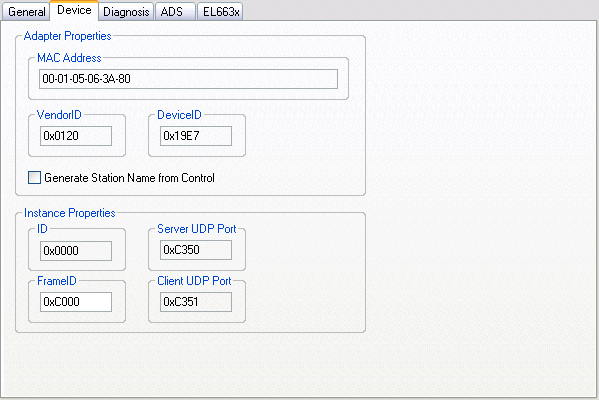

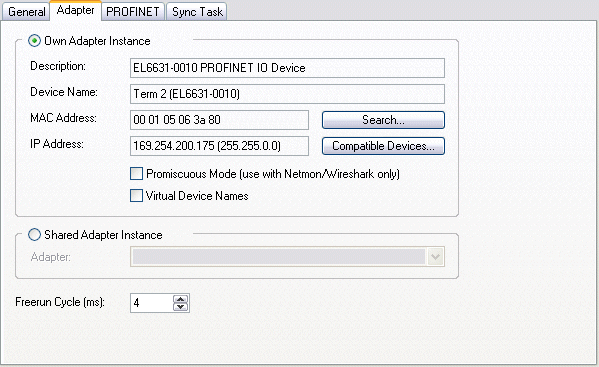

This interface must be assigned to an adaptor class. This is composed of the MAC and IP address of the network card. Use "Search" to look for the corresponding EtherCAT terminal. If there is only one terminal in the system, it will be configured automatically.
PROFINET device (EL6631-0010) integration under TwinCAT 2.11 3:
MAC address:
MAC address of the Ethernet card (read-only)
IP address:
IP address of the card (read-only). The IP address is read from the operating system, and has nothing to do with the PROFINET IP address that will be used later.
Promiscuous Mode
Is not supported by the EL6631-0010
Virtual Device Names:
Shared Adapter Interface:
Free Cycle:
Cycle time in Config mode (no real-time). If TwinCAT is operated in FREERUN mode, care must be taken that the freerun cycle set is not longer than the PROFINET cycle!
If, for example, a CX9000 is to be parameterized, the target system must first be accessed remotely; the corresponding Ethernet port can subsequently be selected.

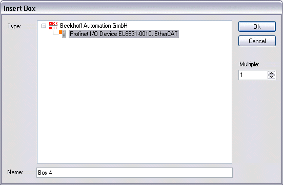

A Box in the form of a GSDML is then integrated (right mouse button on "PROFINET Device").
PROFINET device (EL6631-0010) integration under TwinCAT 2.11 5:

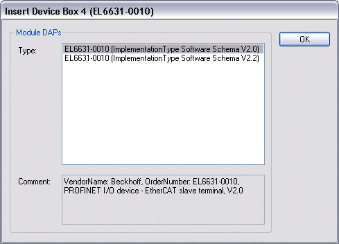

Now select the version to be used to integrate your EL6631-0010. The main difference between V2.0 and V2.2 lies in the support for sub-modules.
PROFINET device (EL6631-0010) integration under TwinCAT 2.11 6:

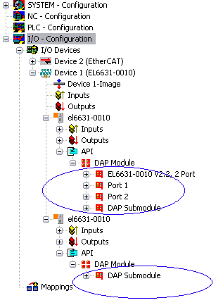

In the first EL6631-0010 (according to V2.2) the ports, and therefore the port diagnosis, can be seen in the DAP. The following EL6631-0010 is integrated according to V2.0. No port diagnosis is possible here. The same version must be used in the master. Older PROFINET controllers can not yet support Version 2.2, in which case you should use Version 2.0.

The FrameID can be changed on the "PROFINET Devices" tab. However, the default settings suffice for normal operation!

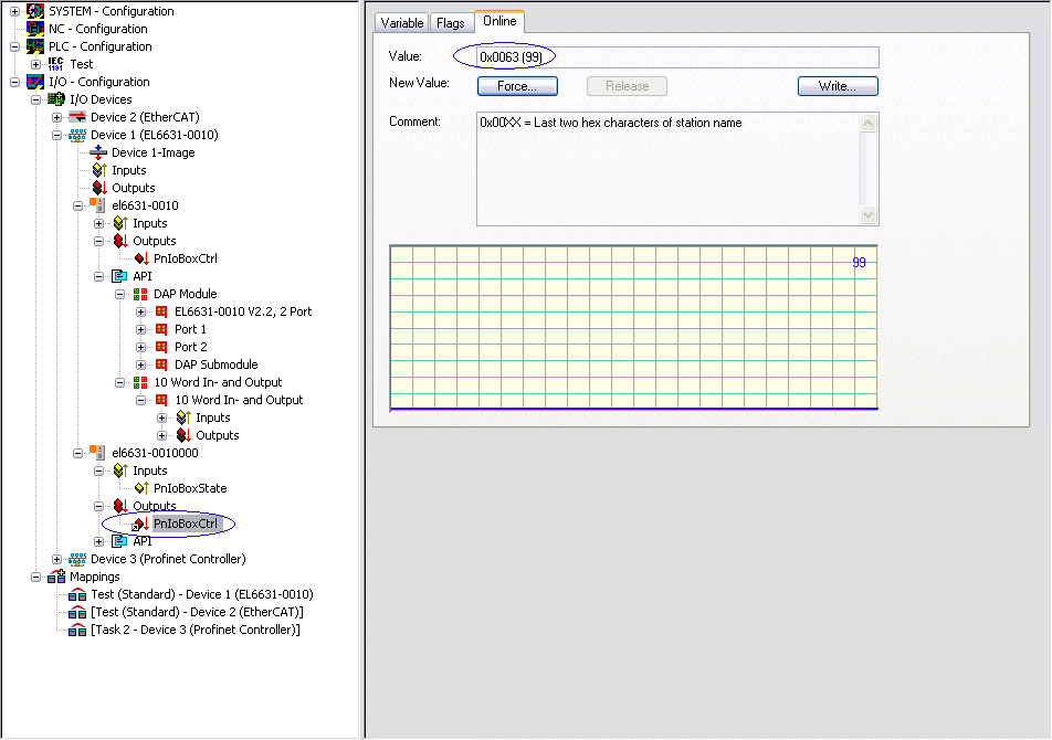

4.1.3 Assignment through a link to the PLC program
This is comparable with the DIP switches in the BK9103 and can be carried out via a PLC task. For activation, "Generate Station Name from Control" must be activated. For clarification, 000 will be appended to the previous tree name (default: "tcpniodevice").
PROFINET device (EL6631-0010) integration under TwinCAT 2.11 12:
PROFINET device (EL6631-0010) integration under TwinCAT 2.11 13:
Tree name
This tree name no longer corresponds to the PROFINET station name! The Ctrl WORD of the PROFINET protocol is used to help assign a name. This means that the number that is entered (range of values 0 - 255) is appended to the existing station name. In addition, the Ctrl WORD must be linked to a task. It is subsequently necessary to restart TwinCAT. If, for example, the task now specifies a value of 11 for the linked Ctrl WORD, its previous station name will change from, for example, "tcpniodevice" to "tcpniodevice011". The current tree name remains "tcpniodevice000".

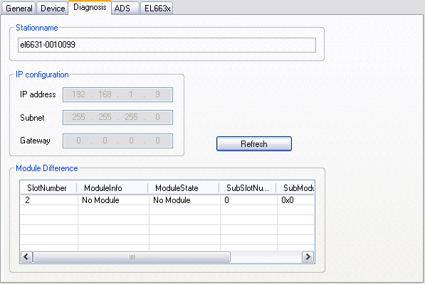

The current station names and the IP configuration used can be checked via the "PROFINET diagnosis" tab.
4.2 Diagnostics
The actual PROFINET name is displayed on the Diagnostics tab. The IP configuration is specified when the master boots up, and has the values that are assigned by the master. The "Module Difference" field is displayed if the specified configuration is not the same as the actual configuration. The field should be empty if there is no error.

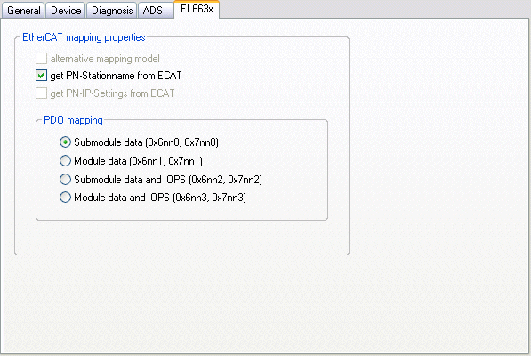

6.0 PDO Mapping
The PDO mapping describes how the PROFINET data is to be represented in the EtherCAT. The "Submodule data" setting should be used if TwinCAT is used.
