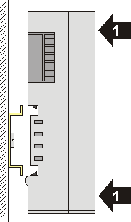

- Fit the mounting rail to the planned assembly location.

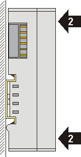

and press (1) the terminal module against the mounting rail until it latches in place on the mounting rail (2).- Attach the cables.

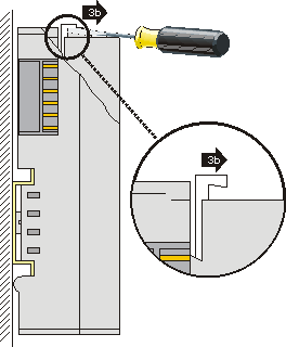

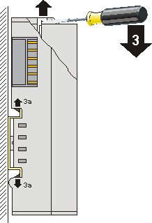

- Lever the unlatching hook on the left-hand side of the terminal module upwards with a screwdriver (3). As you do this
- an internal mechanism pulls the two latching lugs (3a) from the top hat rail back into the terminal module,
- the unlatching hook moves forwards (3b) and engages
- In the case 32 and 64 channel terminal modules (KMxxx4 and KMxxx8 or EMxxx4 and EMxxx8) you now lever the second unlatching hook on the right-hand side of the terminal module upwards in the same way.
- Pull (5) the terminal module away from the mounting surface.
