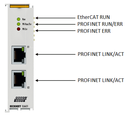

LEDs for EtherCAT diagnosis
LED
Display
RUN
green
off
State of the EtherCAT State Machine:
INIT
= Initialization of the terminal
BOOTSTRAP = Function for firmware updates of the terminal
flashing
200 ms
PREOP = Setting for mailbox communication and variant standard settings
off (1 s)
on (200 ms)
SAFEOP = Channel checking of the Sync Manager and the Distributed Clocks.
Outputs stay in safe operation mode.
on
OP
= Normal operation mode, mailbox- and process data communication possible
LED diagnosis PROFINET RUN/Err
Colour green
Colour red
Meaning
on
off
EL terminal is parameterized
off (1 s)
on (200 ms)
off
EL6631-0010 does not have an IP address
flashing
200 ms
off
EL6631-0010 still has not received a PROFINET name
off
flashing
200 ms
Terminal starts
LED diagnosis PROFINET Err
Colour green
Colour red
Meaning
on
off
EL terminal is exchanging data
flashing
200 ms
off
EL terminal is exchanging data, but the provider status is stopped
off (1 s)
on (200 ms)
off
EL terminal is exchanging data, but the modules are different
off
flashing
500 ms
No AR established,
establishment of connection has not been initialized
flashing
500 ms
flashing
500 ms
Identify EL terminal through PROFINET "flashing"
LEDs starting up
Run
PN Run/Err
PN Err
Meaning
off
off
off
No electrical voltage connected to E-bus. The EL6631-0010 must be exchanged if EtherCAT terminals behind it need to function.
off
off
red on
EL terminal is starting up; after approx. 10 seconds, the LED should go out. If this does not happen, the EL6631-0010 module must be exchanged.
