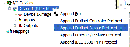

1. Integration of the PROFINET protocol
First, a real time Ethernet device must be added. This interface must be assigned to an adaptor class. This is composed of the MAC and IP address of the network card.
Hence, for example, if a CX9000 is to be parameterized, the target system must first be accessed remotely; the corresponding Ethernet port can subsequently be selected.
A PROFINET protocol is subsequently appended using the right mouse button. Precisely one TwinCAT device protocol can be appended!

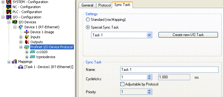

PROFINET device integration under TwinCAT 2.10 2:
The NetID used can be found under the "Protocol" tab. It is required for an ADS access, for example. Besides that, there is a possibility in the "Sync Task" tab to append a free-running task for PROFINET communication (this is recommended). Real time communication can hence run independent of a PLC task. For performance reasons, however (e.g. in the case of a CX9000), the Sync Tasks can be dispensed with and standard mapping takes place, i.e. a PLC task, for example, must be running in order for PROFINET communication to be possible.
