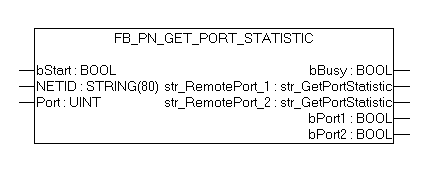

FB_PN_GET_PORT_STATISTIC
FB_PN_GET_PORT_STATISTIC 1:
When called, this module supplies the statistical data for the ports of a PROFINET device.
    bStart  : BOOL;
    NETID   : T_AmsNetId;(* AMS Net ID from Controller *)
    PORT    : T_AmsPort; (* Port used by Controller to communicate with Device *)
bStart :    The block is activated by a rising edge on this input
NETID :     AMS Net ID of the controller
PORT :     Port via which the controller communicates with the device (port = Device ID + 1000hex )
    bBusy            : BOOL;
    str_RemotePort_1 : str_GetPortStatistic;
    str_RemotePort_2 : str_GetPortStatistic;
    bPort1           : BOOL;
    bPort2           : BOOL;
bBusy :    When the function block is activated this output is set. It remains set until a feedback is received. While Busy = TRUE, no new command will be accepted at the inputs.
str_RemotePort_1:    This structure contains the statistical data for Port 1.
str_RemotePort_2:    This structure contains the statistical data for Port 2.
bPort1:    Is TRUE if the port has a link.
bPort2:    Is TRUE if the port has a link.
