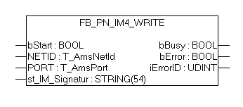

FB_PN_IM4_WRITE
FB_PN_IM4_WRITE 1:
Using this function block the PROFINET controller writes all I&M4 data (Identification & Maintenance) data to a device referenced via the Port input.
The frame structure of the I&M4 function corresponds to the index 0xAFF4 according to PROFINET standard.
    bStart  : BOOL;
    NETID   : T_AmsNetId;(* AMS Net ID from Controller *)
    PORT    : T_AmsPort; (* Port used by Controller to communicate with Device *)
    st_IM_Signatur   : STRING(54);
bStart :    The block is activated by a rising edge on this input
NETID :     AMS Net ID of the controller
PORT :     Port via which the controller communicates with the device (port = Device ID + 1000hex)
st_IM_Signature:    Signature of the manufacturer is written to the device.
    bBusy       : BOOL;
    bError      : BOOL;
    iErrorID    : UDINT;
bBusy :    When the function block is activated this output is set. It remains set until feedback is received. While Busy = TRUE, no new command will be accepted at the inputs.
bError :    If an error should occur during the transmission of the command, this output is set after the bBusy output has been reset.
iErrorID: Supplies an ADS error number when the output bError is set.
