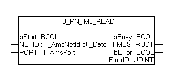

Using this function block the PROFINET controller reads all I&M 2 data (Identification & Maintenance) from a device referenced via the Port input.
The frame structure of the I&M2 function corresponds to the index 0xAFF2 according to PROFINET standard.
bStart : BOOL;
NETID : T_AmsNetId;(* AMS Net ID from Controller *)
PORT : T_AmsPort; (* Port used by Controller to communicate with Device *)
bStart : The block is activated by a rising edge on this input
NETID : AMS Net ID of the controller
PORT : Port via which the controller communicates with the device (port = Device ID + 1000hex)
bBusy : BOOL;
str_Date : TIMESTRUCT; (*YYYY-MM-DD HH:MM*)
bError : BOOL;
iErrorID : UDINT;
bBusy : When the function block is activated this output is set. It remains set until a feedback is received. While Busy = TRUE, no new command will be accepted at the inputs.
str_Date : Returns the date of installation of the device in the format < YYYY-MM-DD HH:MM >.
bError : If an error should occur during the transmission of the command, this output is set after the bBusy output has been reset.
iErrorID: Supplies an ADS error number when the output bError is set.
