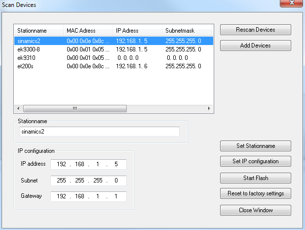

After successful scanning the following dialogue opens (if devices were found).
Button Scan PNIO Devices 1:
Various settings or project planning can be carried out for the devices here. These are adopted only when the corresponding button is explicitly pressed. When setting the name, care must be taken that only PROFINET-compliant characters are used. This also applies to the IP address; only valid combinations of IP and subnet are to be used. Name and IP are checked for correctness when setting PROFINET devices. DCP_SET is acknowledged with an error If this is not the case. Changes that have been made can be read back by pressing the Rescan button.
In addition the selected device can be signalled. This functionality is PROFINET-specific, but the method by which the signalling takes place is vendor-specific. As standard, however, the signal must arrive with a frequency of 2 Hz.
For example, the Beckhoff BK9103 Bus Coupler signals itself by the alternate flashing of two LEDs at a rate of 2 Hz. This function is very helpful for identifying the devices in this list. The flashing is stopped again by pressing the button once more. The flashing is stopped by closing the ‘Scan Devices’ window.
Subsequently, one or more devices can be marked with the Ctrl button . The selected device is adopted into the project by pressing ‘Add Devices’.
